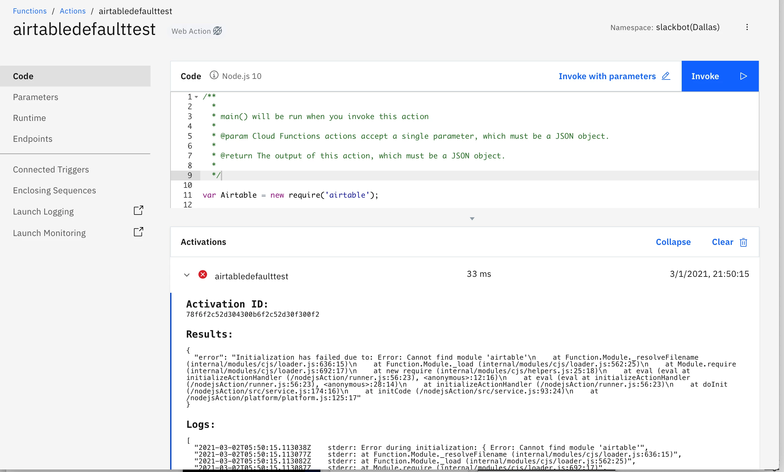

When I try to run this code, I get
Error: Cannot find module ‘airtable’\n

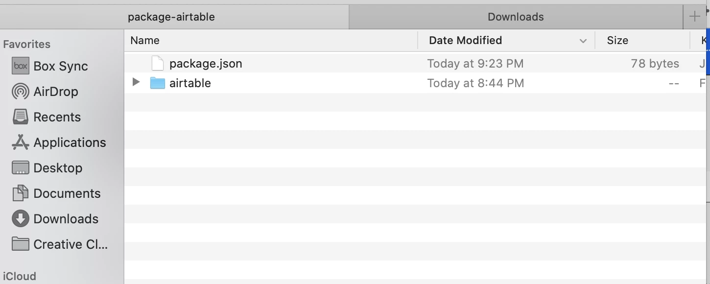

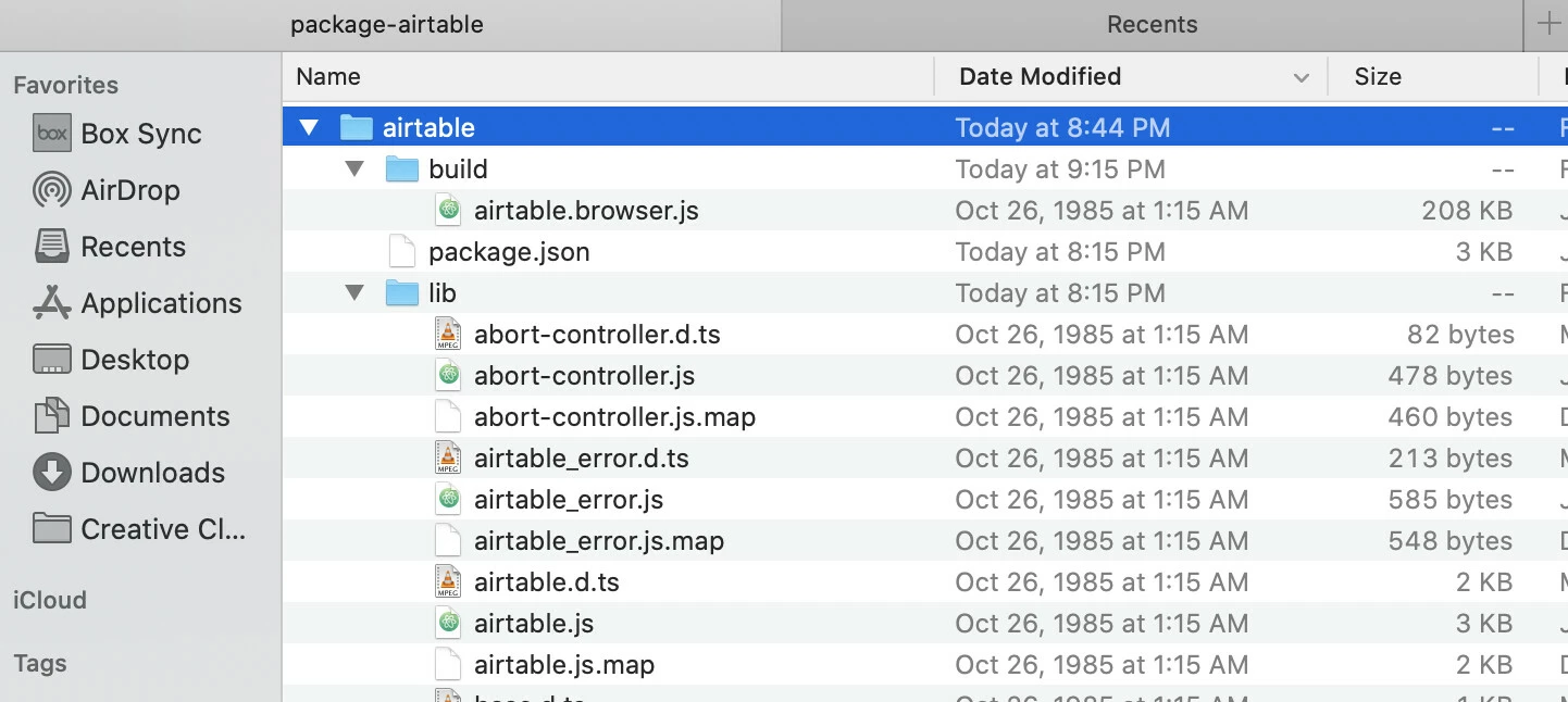

  1. I create a new folder in my directory called “package-airtable”. I copy the “airtable” folder from j_mai > node_modules > airtable, into the “package-airtable” folder. So I have a new folder in “j_mai > package-airtable” with the airtable folder you see below.
  1. I then create a package.json file in the folder “package-airtable” with the name: “my-action” and “dependencies” “airtable”: “^0.10.1”

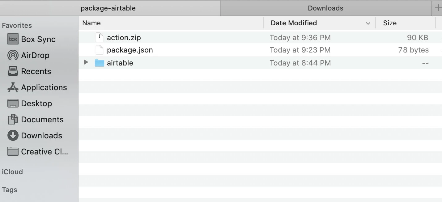

  1. Then I create a zip folder, called “action.zip” with the package.json and the “airtable” library.

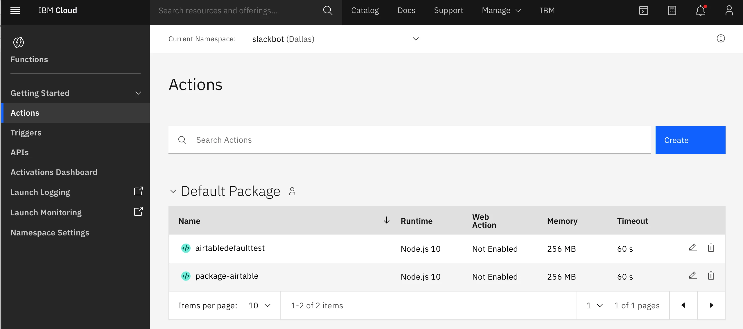

You can see here the “package-airtable” gets created.

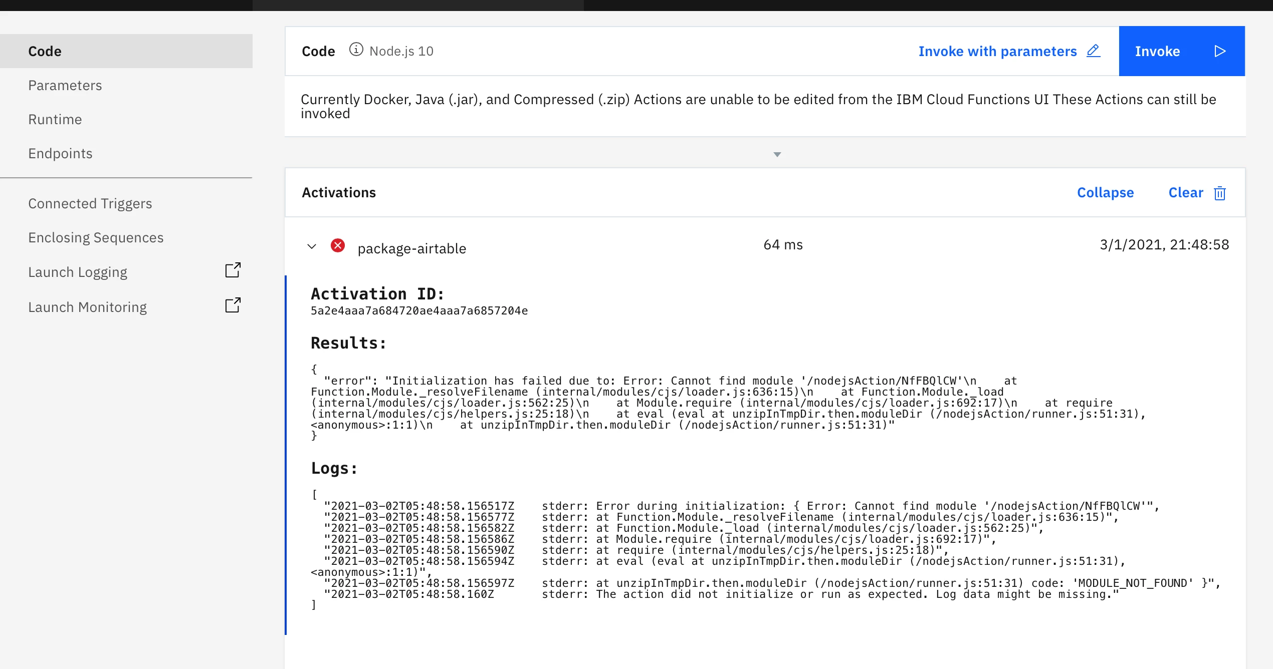

  1. I’m not sure if I’m supposed to, but I click “Invoke” on the “package-airtable” and I get an error message about not being able to find a module nodejsAction.
  1. If I go back to my “airtabledefaultest”, I run into the same error at the beginning, "Cannot find module ‘airtable’\n.
