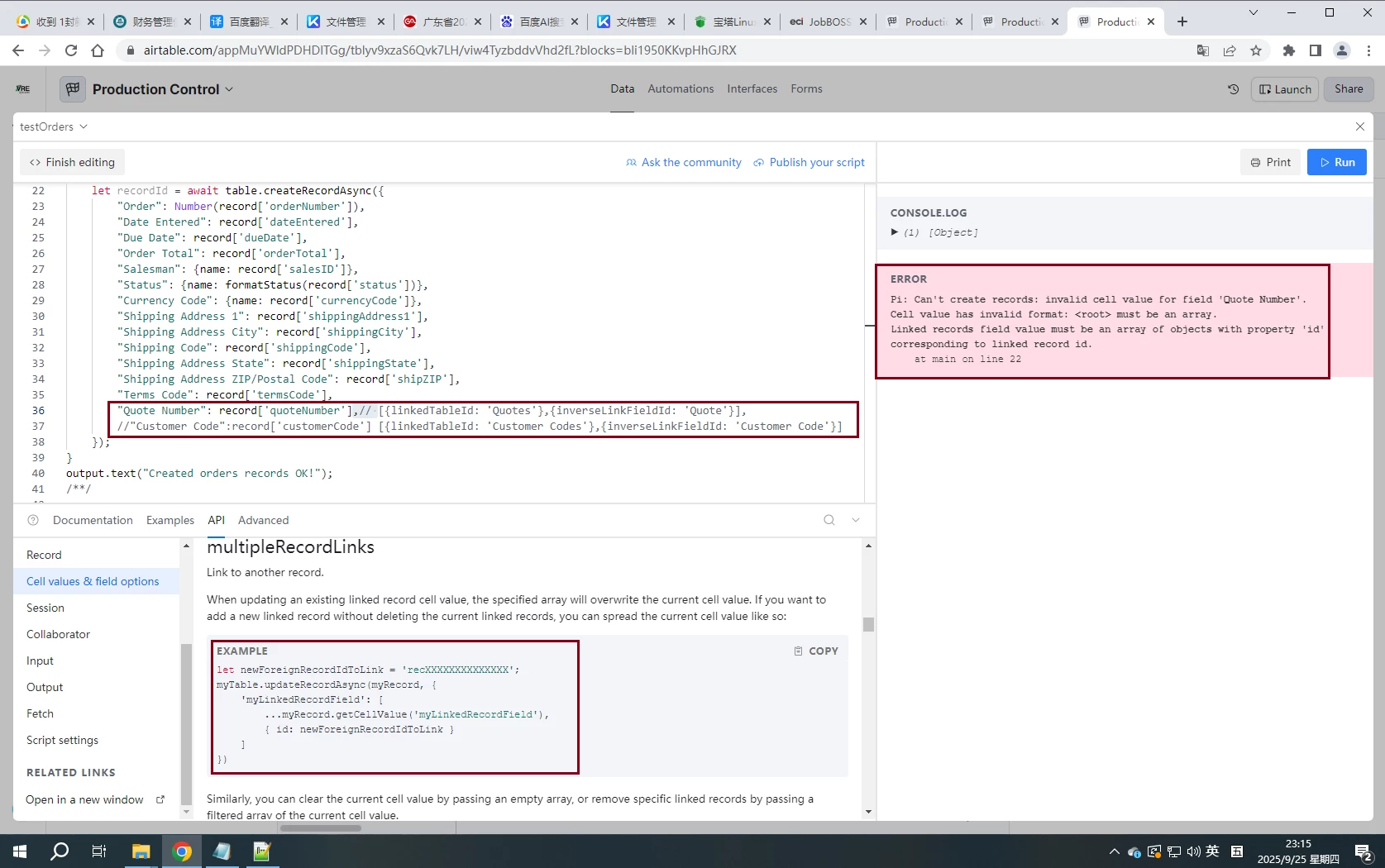

let table = base.getTable("Copy-Orders");
for (let record of resulttxt['Data']) {
    let recordId = await table.createRecordAsync({
        "Order": Number(record['orderNumber']),
        "Due Date": record['dueDate'],
        "Order Total": record['orderTotal'],
        "Quote Number": [{id: '24229'}],
output.text("Created orders records OK!");
//tips:The field name is "Quote Number", the associated table name is "Quotes", the associated field is "Quote", and record['quoteNumber'] is the value to be inserted.
how to deal with the  "Quote Number": [{id: '24229'}], for example,the value of Quote Numbe is  '24229'. thank you.

Thank you very much. I know how to get the recordId now. but there is an another question, about the function queryQuote.records.find(record => record.Quote == record['quoteNumber']) //?
the field type of the value record['quoteNumber'] is string, and the field type of Quote table
PRIMARY FIELD ‘Quote’ is Number,  the queryQuote.records.find() can not work, how can I deal with this problem? thank you !
//1.get orders data
let resulttxt=await response.json();
//let resulttxt2=JSON.stringify(resulttxt);
console.log(resulttxt['Data']);
let lengthofdata=resulttxt['Data'].length;
let tableQuote = base.getTable("Quotes");
let queryQuote = await tableQuote.selectRecordsAsync();
//2.insert orders data
    //output.text(Number(record['quoteNumber'])+"-0:");
    let recordToFind = queryQuote.records.find(record => record.Quote == record['quoteNumber']) //?
    output.text((record['quoteNumber'])+"-quoteId:"+ recordToFind.id);
        "Quote Number": [{id: recordToFind.id}], //record['quoteNumber']  [{id: 'recnLbZrx0QGtIBYQ'}]
        //"Customer Code":[{id: 'recNG3GuSBM5zXakF'}],
