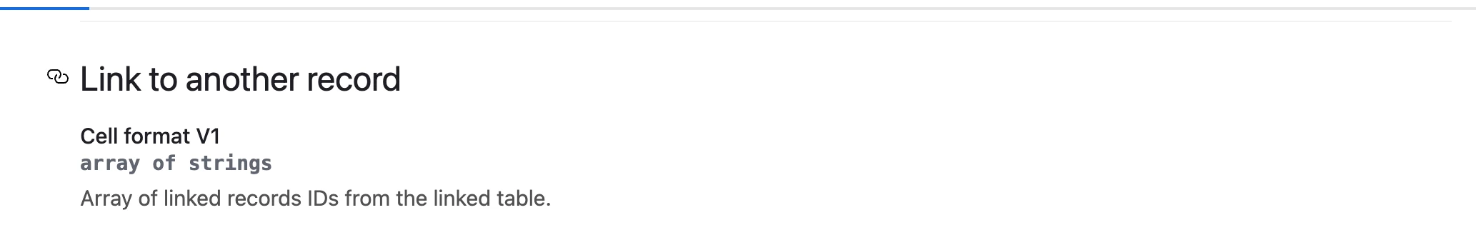

Yup! For anybody looking for further information on this matter, it might make sense to take a look at Airtable’s API documentation when it comes to Link to Another Record field values.
As shown, this is expecting an Array! Hope this provide some more context to it.
