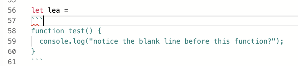

I’m trying to use my Airtable base to output multiline code snippets based on the records, but I can’t seem to figure out how to give the output.markdown() the correct strings to render something like:
function test() {
  console.log("notice the blank line before this function?");

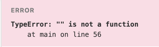

It works fine when using the single back tick, `, to create a preformatted text style, but if I use the triple back-tick like so, ```, it throws an error. Here’s an example:

Hmm, it doesn’t seem to work for me:
  • June 22, 2020
