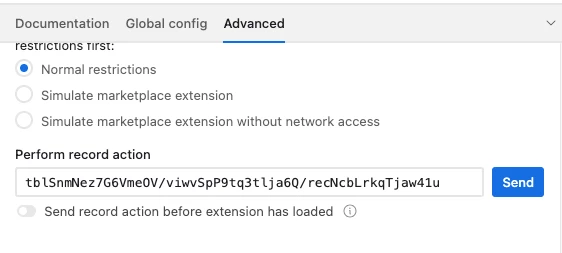

Hm, when testing useRecordActionData, could I confirm you’re testing it either with via ‘Perform record action’ below, or after you’ve released the app?  Just tried it via Perform record action and it received the record ID fine

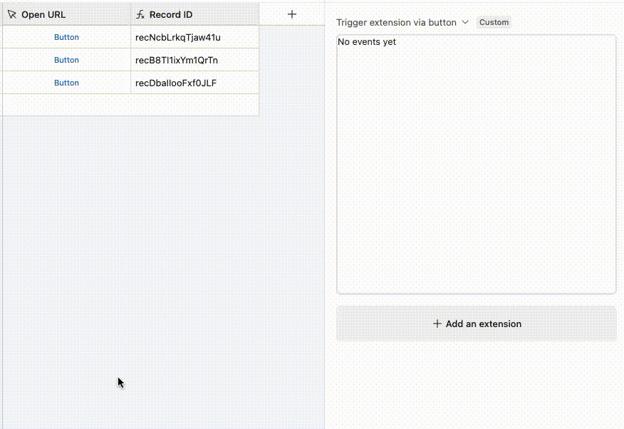

I can use that to get data output to the console, but not to the extension. What is the trick to getting your extension to react to this record action so that execute code based on the selected record and display results back to the user?

But every time I send a record action via Perform record action, the component still displays “Please select a record.”

Interesting. Using your code, my buttons still don’t change anything in the extension (though the Perform record action manual check works now). What is your button field configuration? Or do you need to deploy the extension for the button actions to work properly?
  • August 22, 2025
Got it! I had to release the block. Thanks for your help.
