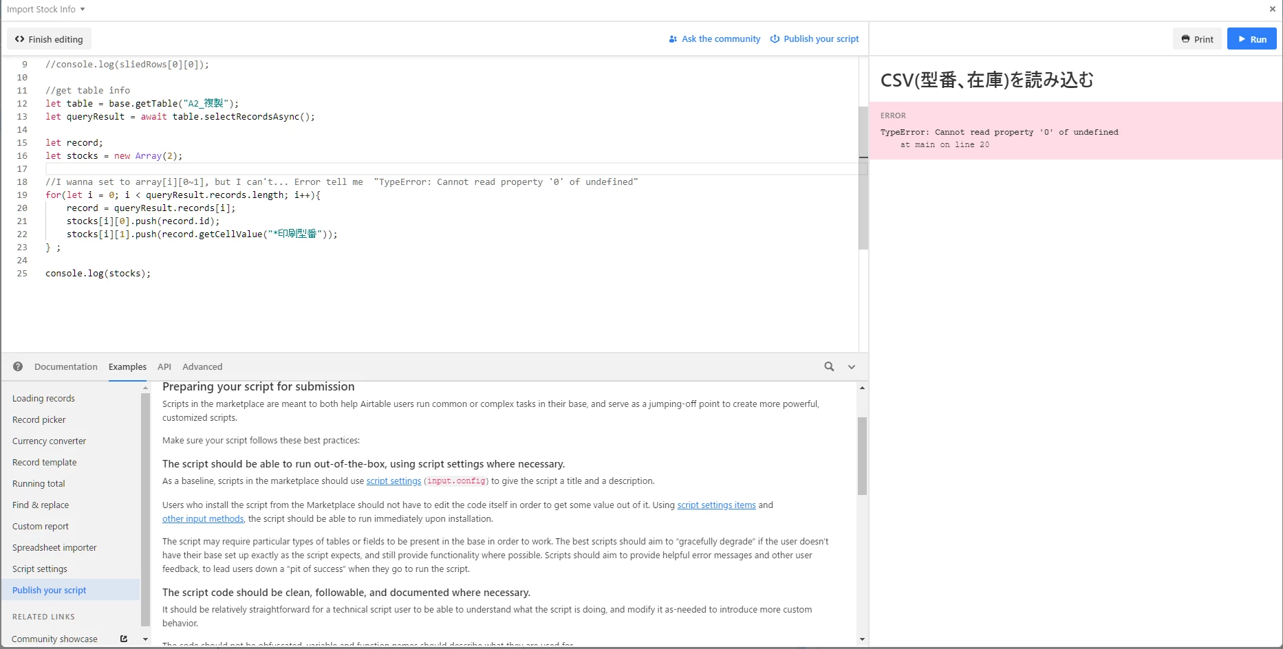

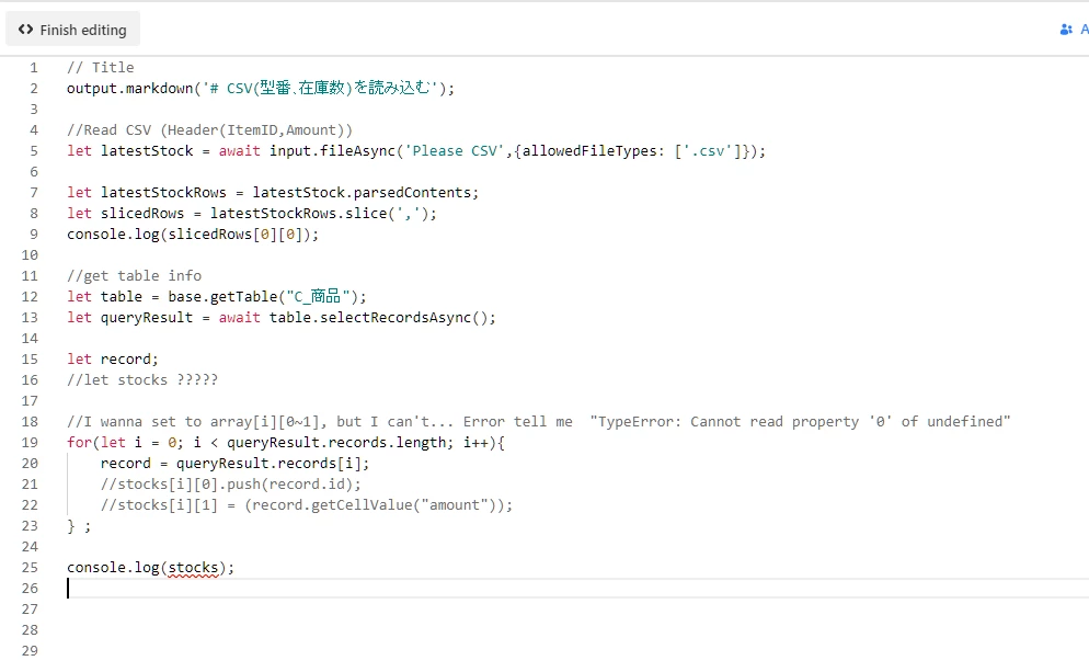

I have this probrem.Preformatted text
please let me know.
//get table info
let table = base.getTable("A2_複製");
let queryResult = await table.selectRecordsAsync();
let record;
let stocks = new Array(2);
//I wanna set to array[i][0~1], but I can't... Error tell me  "TypeError: Cannot read property '0' of undefined"
for(let i = 0; i < queryResult.records.length; i++){
    record = queryResult.records[i];
    stocks[i][0].push(record.id);
    stocks[i][1].push(record.getCellValue("*印刷型番"));
console.log(stocks);

Hello @111257, welcome to the community :slightly_smiling_face: . I’m not sure what the script is trying to do but there are some semantic errors. E.g. stocks[i] will return the ith item which will be undefined since it doesn’t contain any objects after the let stocks = new Array(2); statement (there are two slots for objects in the array, but those slots are not filled with any object). Then the next [0] is trying to get the 0th item from undefined. Hence the error - Cannot read property '0' of undefined.
If you could maybe describe what the script is trying to do we can help you.
new Array(2) just leaves you with an empty array whose length is set at 2, any index number will return undefined.
Please try explaining what you’re trying to accomplish in a bit more detail as I’m afraid this code isn’t too revealing.

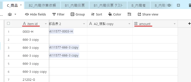

I work in Internetshop.

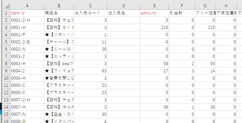

I have to update the stock amount of merchandise. The stock amount in Airtable’s table “C_商品” at Field “amount”. At that time Key is “item id”.
I upload CSV(latest stack amount) from another system.
this is CSV.↓
If “item id” is much then update amount.
so,I first tried to set the CSV to an array.
