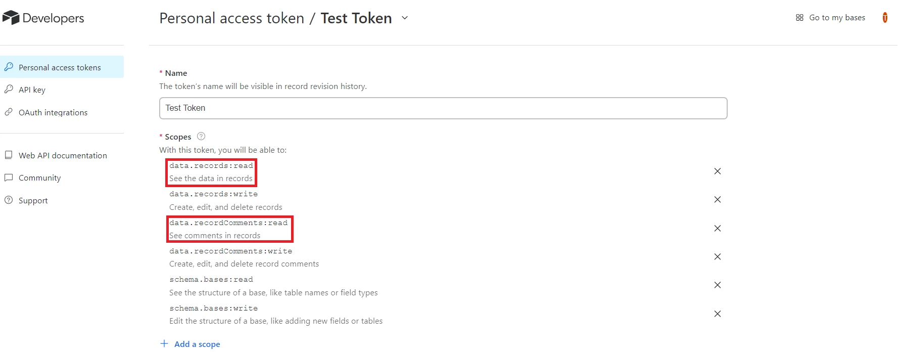

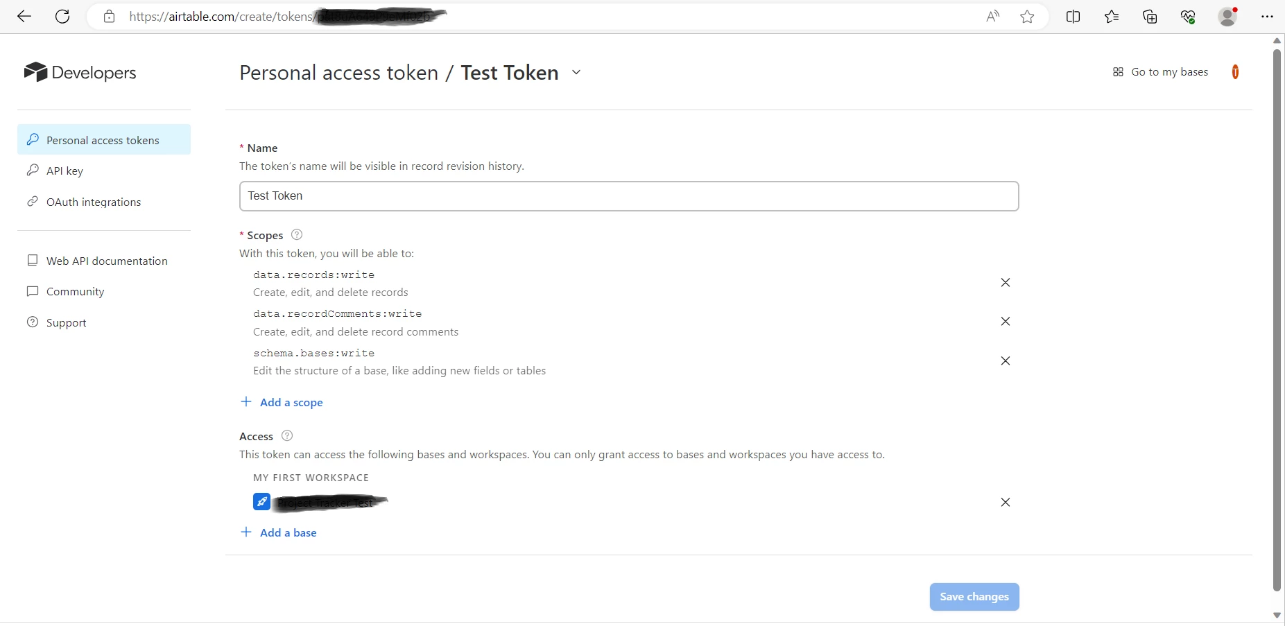

Thanks @philm . The issue was I hadn't granted read permission to my personal access token. Please see attached image as reference.
