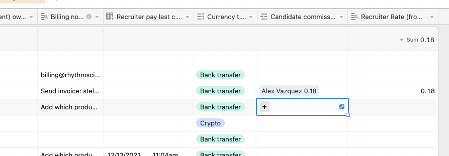

I have a Timesheets base with a “Timesheets” table that is filled when my workers submit timesheets each month.

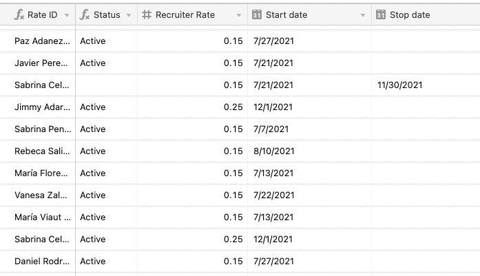

I have a separate “Rates” table (in a different base) that is synced to my Timesheets base and table.
In this Rates table, I have a list of rates connected to each of my referral partners, including a start and stop date. If they do not have a stop date then that rate is considered active, if it does have a stop date than that is not an active rate.
My problem is that I am currently manually syncing the Rates table Referral partner to the Timesheet entry, and it’s too much work and error prone.

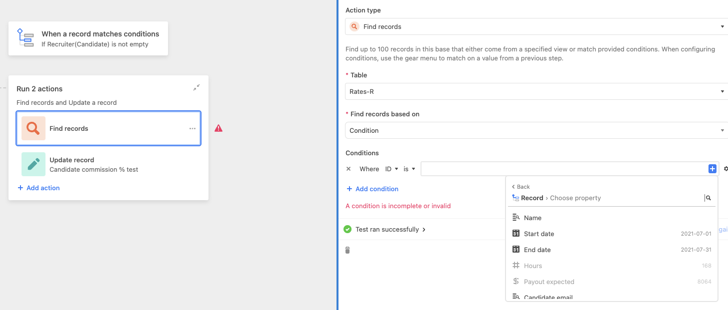

This can be done without a script, but you’ll need to add another field to your [Rates] table first. Make it a link field to the table containing your referral partners, and link each rate to a partner. With that done, you can set up an automation that runs like this:
  • Trigger: “When record matches conditions”, with the condition being that the field linking a given timesheet record to a referral partner is not empty.
  • Action 1: “Find records”. Find the rate record where the link to its associated partner matches the timesheet’s partner link (matching by the text in the primary field)
  • Action 2: “Update record”. Update the triggering timesheet record to link to the found rate record.

There is still a problem.
I set up a trigger when the submitted timesheet has a connected Recruiter (same thing as referral partner), however Airtable will not let me find a record based on the look up fields of that timesheet row, i.e. the recruiter’s email, which makes it impossible for me to find the record since the timesheet entered data would not have anything about the Recruiter, it would be connected to the candidate who submitted the timesheet.
I’m still stuck on how to automate the finding and linking a row in a table to another table through the Linked field.
