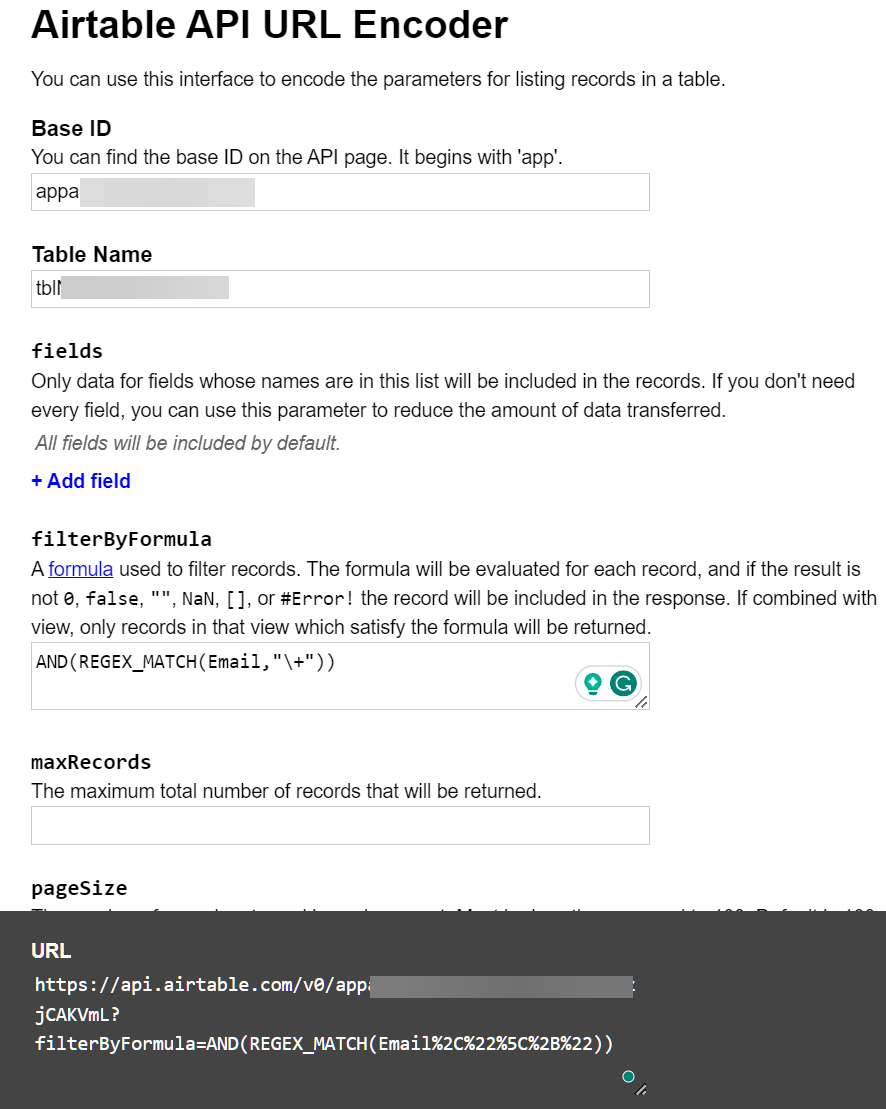

First of all use this to encode your url and change input parameters accordingly. https://codepen.io/airtable/full/MeXqOg

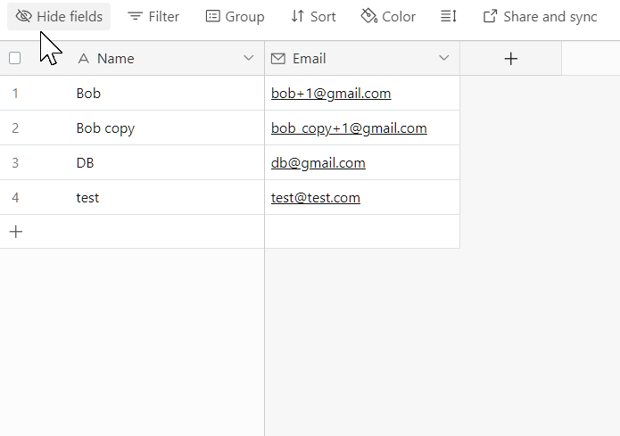

This is my created table just for testing purpose.

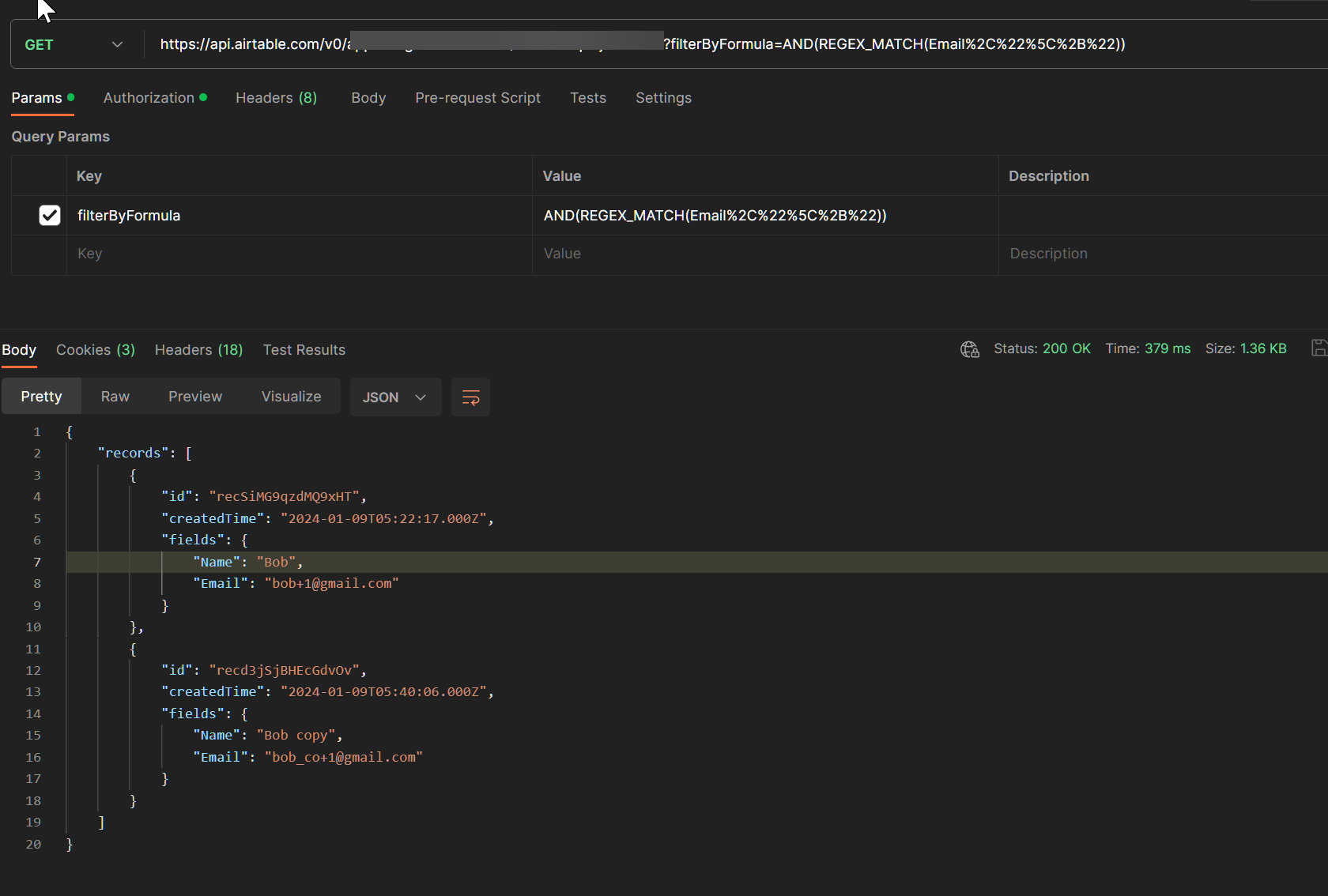

I've used Regular Expression based function with filterByFormula. check it https://support.airtable.com/docs/guide-to-regex-functions
My testing response image.
URL Encoder image.
