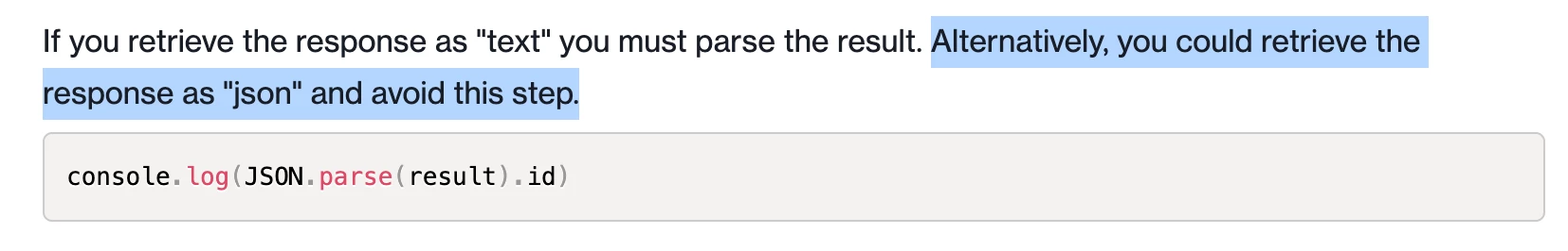

If you retrieve the response as "text" you must parse the result. Alternatively, you could retrieve the response as "json" and avoid this step.
console.log(JSON.parse(result).id)
