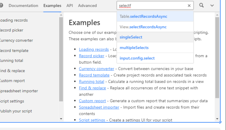

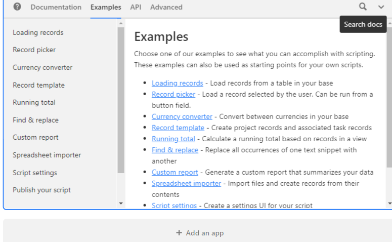

As a rule of thumb, on top of never doubting the debugger, always start debugging from the examples part of the scripting app, it adjusts its references to account for your own data in a given base and you could literally force it to spit out the exact code you need to at least initiate every type of action you can perform in every type of field you and table you have access to.
If you’re adamant to continue powering through like this, that is the only way for you not to lose your mind trying to read an elaborate technical specification written by someone with at least a decade of JS coding experience under their belt.

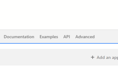

That means going from “I need to update single-select field cells with a script” line of thinking to:
this
then this
and finally this
Leaving you with this
Which might be enough for you to notice those pretty curly braces, so prominently disjointed from your content. The thing is, that’s no way to learn JavaScript syntax, which is a topic you could fully master in a matter of days; simply follow the very links from those screenshots above. Mozilla should have you covered for a good long while, knowledge-wise.
