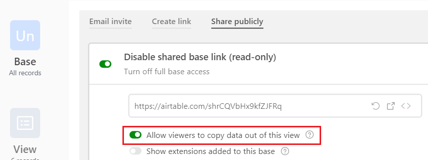

Hi @Deb_Beardsley,
This might actually be doable with Airtable automations with some minor tweaks to your data structure. Could you please allow your shared base to be copied so I can take a stab at it? 🙂

https://airtable.com/shrv13bFF8qaJjJRj
@Stephen_Orr1 I updated it! Thank you!
