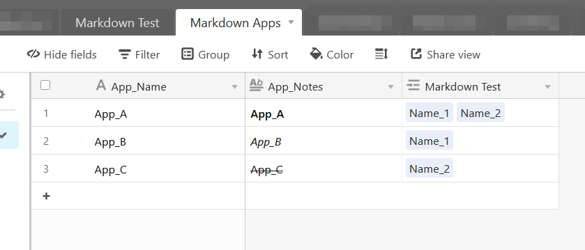

Hey all,
I’ve tested a simple script that takes two Rich Text fields and copies them into a third field, and excitingly the Markdown format keeps as I’d hoped. :partying_face:

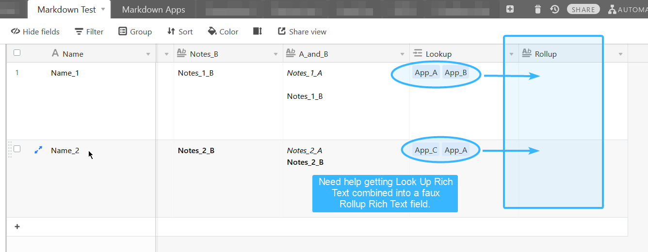

My next step is to now have two tables in a base, a primary table that has field lookups to the secondary table. And then any lookups added to the primary table record - to have their single Rich Text fields (in the Secondary Table) combined into the Primary table Rich Text Field. I’m basically substituting the Airtable RollUp formula due to it lacking support for Rich Text, as although the Rollup works unfortunately it drops all formatting (and I’ve since written a support request to address this).
Here’s my work so far, keep in mind I’m still learning JS so this is all new to me. I understand some of the basics, but am struggling to understand the syntax of how to place the Lookup Name values into a For Loop, and then assign each of their Rich Text contents to a variable that I then combine into the Primary Table record field, hopefully I’ve explained well enough for people to understand.
I’m assuming I need a loop in a loop, but… just can’t get the syntax correctly understood.

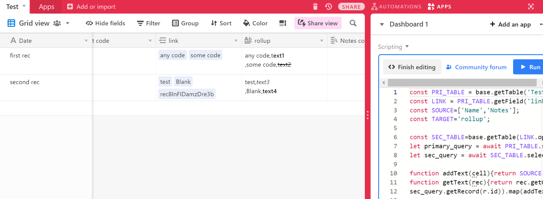

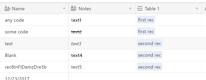

your task can be done in such way (with correct const variables):
const PRI_TABLE = base.getTable(“Test”);
const LINK = PRI_TABLE.getField(‘link’);
const SOURCE=[‘Name’,‘Notes’];
const TARGET=‘rollup’;
const SEC_TABLE=base.getTable(LINK.options?.linkedTableId);
let primary_query = await PRI_TABLE.selectRecordsAsync({fields:[LINK]});
let sec_query = await SEC_TABLE.selectRecordsAsync({fields:SOURCE});

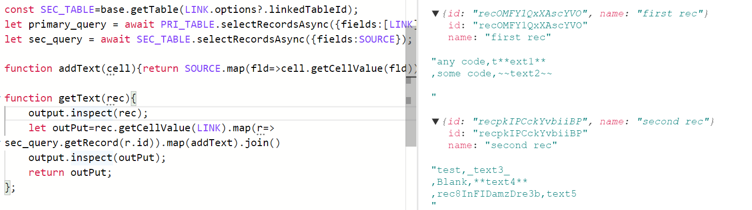

function addText(cell){return SOURCE.map(fld=>cell.getCellValue(fld)).join()};
function getText(rec){return rec.getCellValue(LINK).map(r=>
sec_query.getRecord(r.id)).map(addText).join()};
function setValue(rec){return {‘id’:rec.id,‘fields’:{[TARGET]:getText(rec)}}};
let updates=primary_query.records.map(setValue);
while (updates.length) await PRI_TABLE.updateRecordsAsync(updates.splice(0, 50));

Thanks for having a look @kuovonne - my code is more or less just me learning/debugging and I was reserved about posting it cause of its gaping holes, but decided it was needed for the context of my ability (at time of writing). The pictures are probably best to go off, and my ultimate goal being that I’m just trying to create a manual script “Rollup” that will push Rich Text Lookup fields into a summary. Rollup will do this with ordinary text but unfortunately it doesn’t support Rich Text markdown formatting - and I figured this is the perfect opportunity for me to learn JavaScript in depth.
@Alexey_Gusev - parsing the lookup array is exactly what I’m needing to do, and then pull the Rich Text field for each of those array entries, concatenating them into a main Rich Text field. The things you’ve pointed out are invaluable to know, thanks! I’ve just signed up to JS training at W3Schools and figure I’ll get JS basics fully understood, and then I’ll come back here once I have a working prototype.

Yes, yhat’s exactly what’s the script doing.
You can also apply filtering setting .filter() before each join, or substitute .join by you own function
I would recommend to experiment for better understanding, and that’s also good for debug
