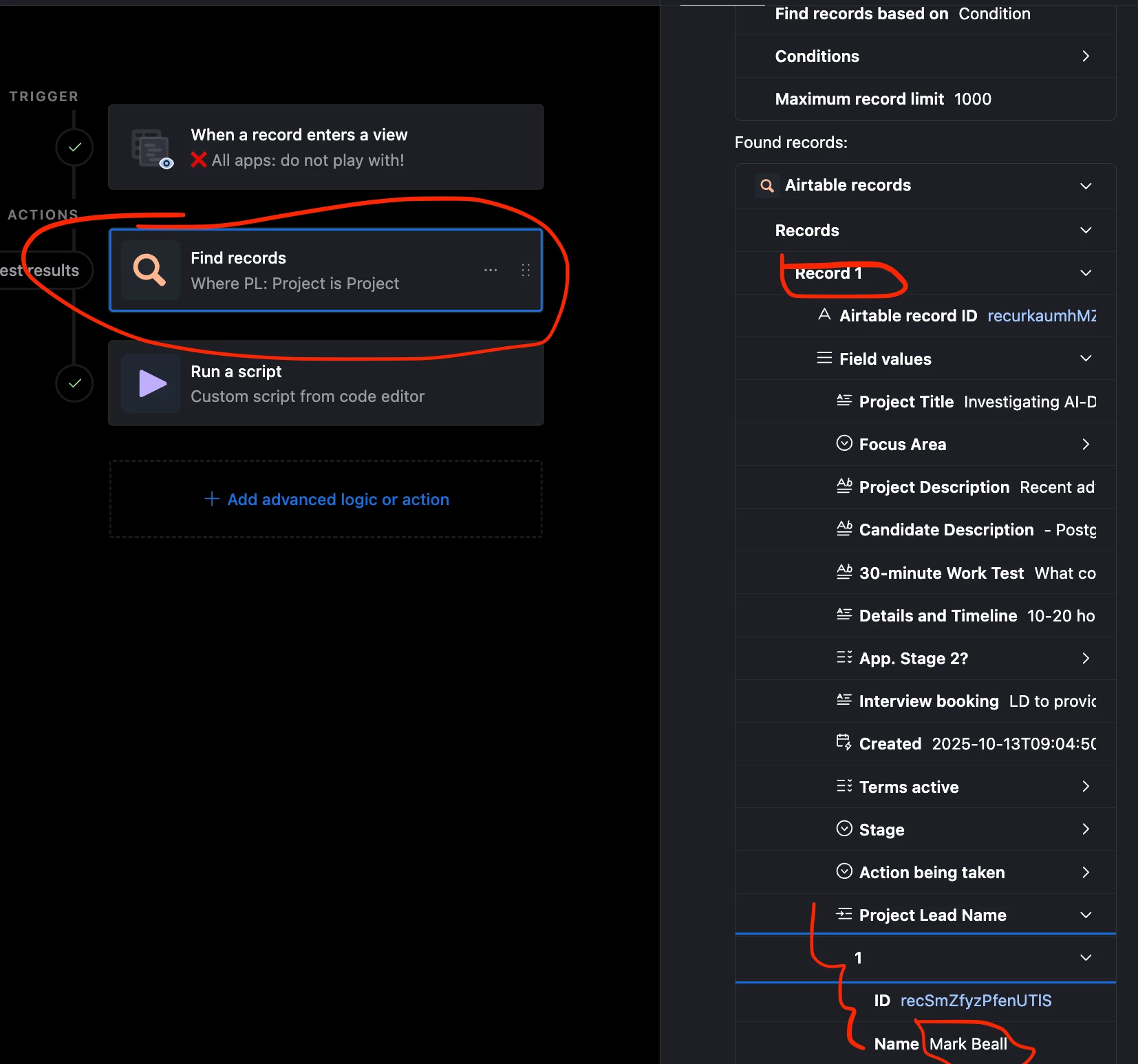

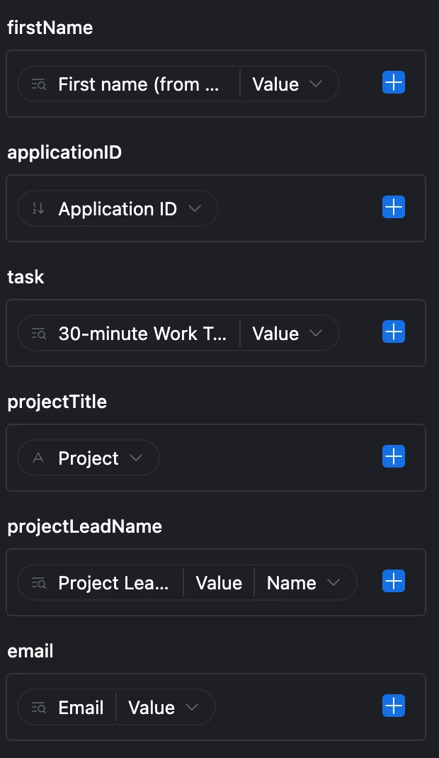

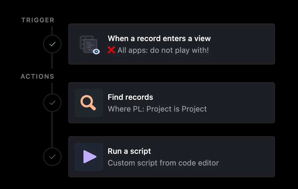

I want to send emails via SendGrid. this is to be done through an automation baed on a trigger of when a record enters a view, like this:
The email text contains many personalisations, pulled from the database. Some of these fields are lookup fields from other databases. Below are all the personalised fields:
And here is the script:

However, when the automation is turned on it changes. The emails get delivered, but not all the personalised values appear in the email text. Namely `projectLeadName` and `task` do not appear.

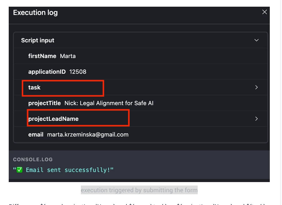

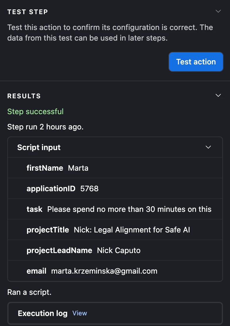

Hm that’s strange.  In emaildata.content, we’re using ${record.projectLeadName} and ${record.task} instead of ${projectLeadName} and ${task}, is that intended?
Could you provide a screenshot of the automation run history for one of the runs where it didn’t send out all the personalized values?  Specifically, the Run a Script action’s input data, as well as the console logs for that run?
Alternatively if you could private message me a link to your base I could take a look for you too!
Marta_Krzeminsk
  • October 29, 2025
test step
execution triggered by submitting the form
Difference: ${record.projectLeadName} and ${record.task} vs ${projectLeadName} and ${task}.
I (strongly believe I have) tested both, can’t remember which version was on for the logs I attached above; we can assume the ${record.projectLeadName} and ${record.task}. I will test the other one again a few hrs to make sure this was also failing.
Hm in the screenshot ‘execution triggered by submitting the form’, the ‘task’ and ‘projectLeadName’ inputs are empty, which means the script isn’t getting values at all, and so it makes sense that the resulting email output doesn’t put anything for those values?
Can we add some conditions to the automation so that it only triggers when the fields for those two values aren’t empty?

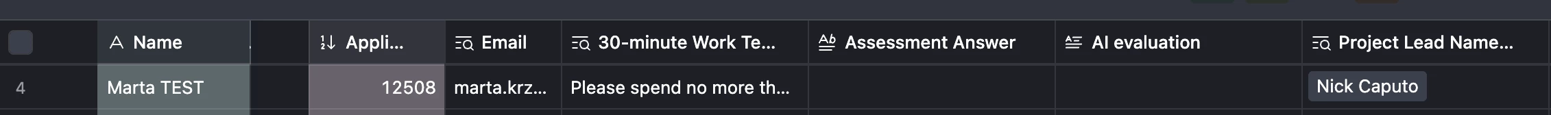

Marta_Krzeminsk
  • October 29, 2025
That’s the crux of the matter, in the table this script is pulling from these values are not empty. They should be the same as on the first screenshot I shared.
For some reason these inputs are not received (not parsed well? idk), and hence not added to the email. I don’t know where in the process they disappear.
Below is the same record in the DB where you can see that the values in the respective columns exist.

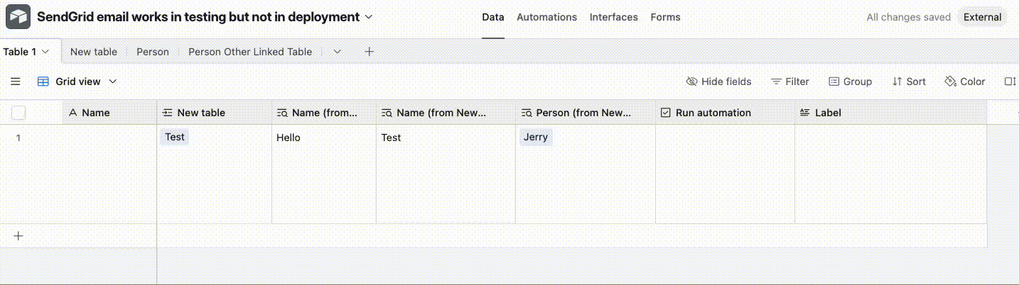

Hm I tried to replicate the issue but wasn’t able to, and you can find my test base here
The one difference is that my script input shows the data immediately without the ‘>’ on the far right:
I experimented a bunch but wasn’t able to get that ‘>’ to show up and without access to a copy of the base it’s difficult to help I’m afraid.  Hopefully someone else has a better idea!

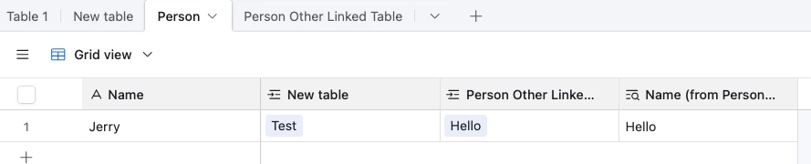

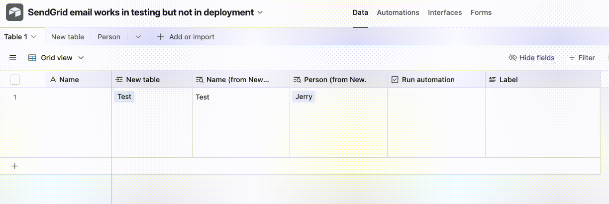

Extra info I just found out: Looking at the structure of the DB. One of the lookup fields in the DB I’m using to compose this email links to a DB in which it’s already a lookup field. My guess was that by using record.projectLeadName[0] I was just retrieving an empty array (potentially an array of arrays).
However, when I test the type (typeof record.task[0], typeof record.projectLeadName[0])) they are both strings. And yet the email returns empty values in these places. idk what else to test.
Btw. I’m talking to Claude  to solve it too, so we’re not relying only on my mind here 😅

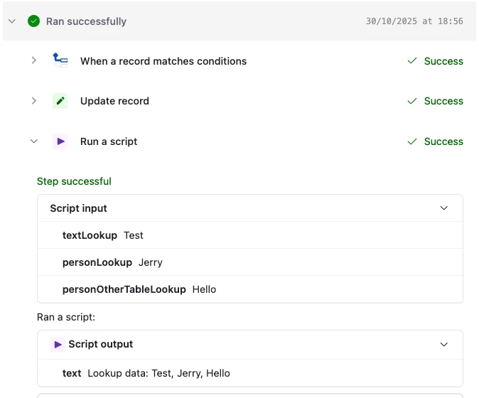

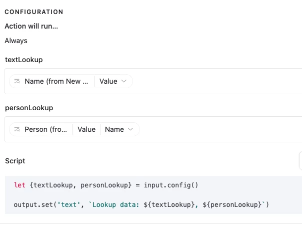

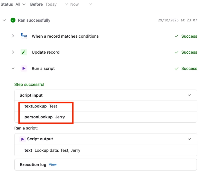

Hm, I just tried making the lookup of a lookup like you mentioned and it worked fine for me as well I’m afraid:
Data:
Automation run:
