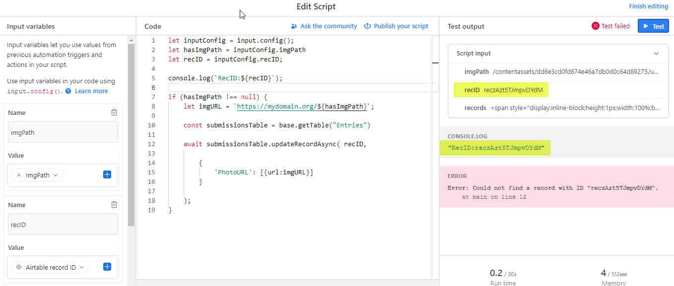

Thanks so much for your continued help. For some reason, the script is not finding the record as the ID that gets passed into the script is not the same as the record in the table:
My Table:
Script:
Automation:
I also tried just using the ID (autonumbering) field to locate the record but for some reason that is not recognized by the script when including it in the Input variables.
  • August 9, 2023
Updated input variables to point to correct action steps and Sho's answer above is working. Thanks again!
