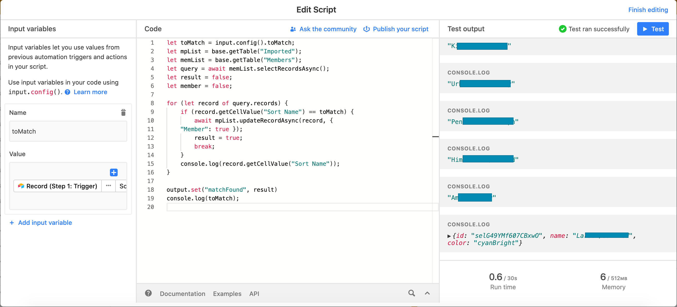

Thank you so much! Both of the fields are long text fields. I’m attaching a screenshot of the test with your advice to use console.log (thank you for that, I’d totally missed that possibility), redacting the exact names involved!
From that, it does totally seem like the query is pulling out the values I want, but the toMatch value from input.config is not returning just the cell value. Is there a best way for me to configure that value so that it returns the field contents (specifically the name)?

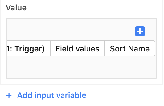

Edit: also attaching the full view of how I set up toMatch from the left window:

It looks like your sort name field is a single select, not a long text field. Has the field type changed?
What happens if you re-test the trigger and then try running the automation again?

You are brilliant and I’m very grateful for your patience with this. I had earlier changed the field type form a single select to a long text field and re-set up the trigger, but testing the trigger again did the trick and toMatch now shows up as just the name string.
