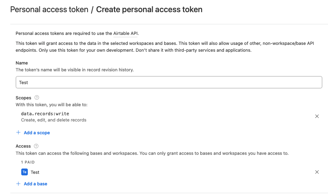

Ah, no worries!  You mentioned you weren't too sure how to use your PAT, so here's how I would set up my PAT so that you have a reference:
You'll just need to give it write permissions and select the base you want to send data into
