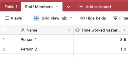

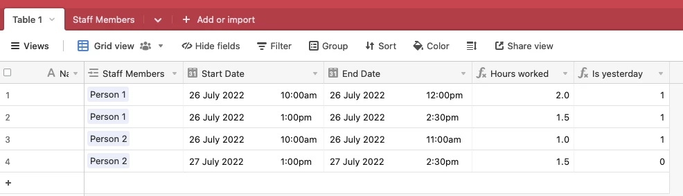

I’ve put something together here that should be enough to get you started if you choose to do this!
Time tracking table:
Staff members table:
