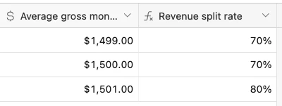

Hmm, what problems are you facing with setting this up?  I've set something up here for you to check out to see if it helps

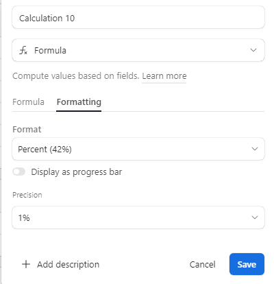

Give this a try
IF({Q2 avg month revenue} > 1500, 0.7, 0.8)
Then set the formula field formatting to percentage:
