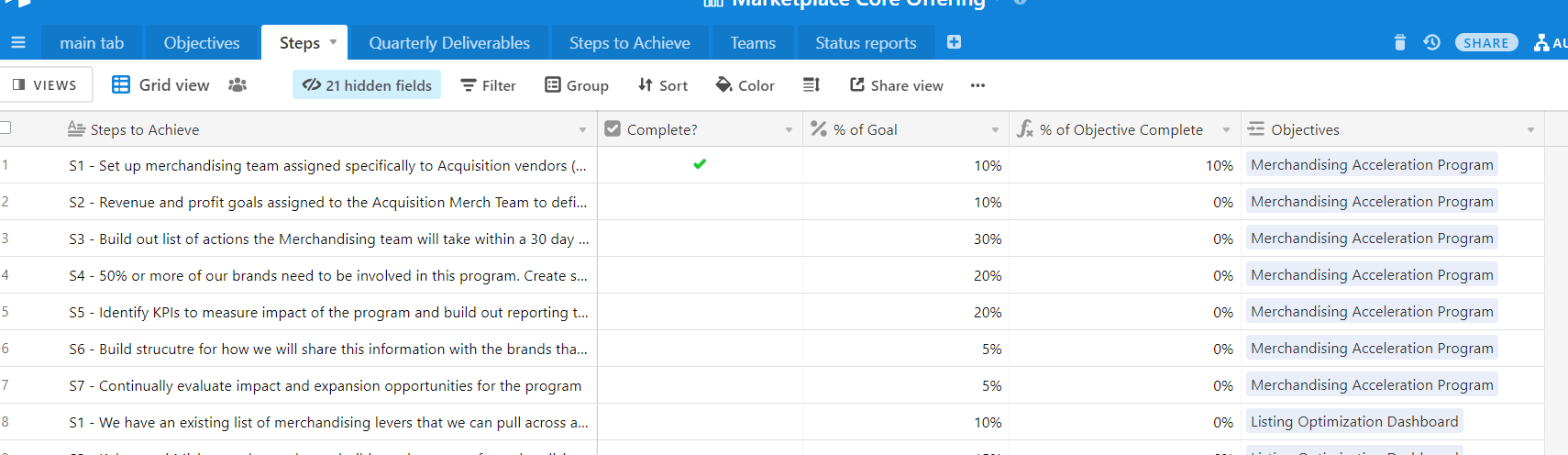

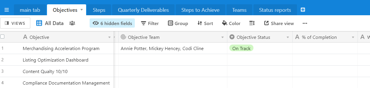

I have two tables - Objectives and Steps. Each step within the objective has a different “weight” / percentage tied to it, based on its importance. I need to add up the % of completion within each objective based on the weight of each step, since each step is not equal in value.
Objectives table:
Steps Table:
So ultimately I would see on the Objectives tab the % of completion based on the steps “checked” in the Steps table

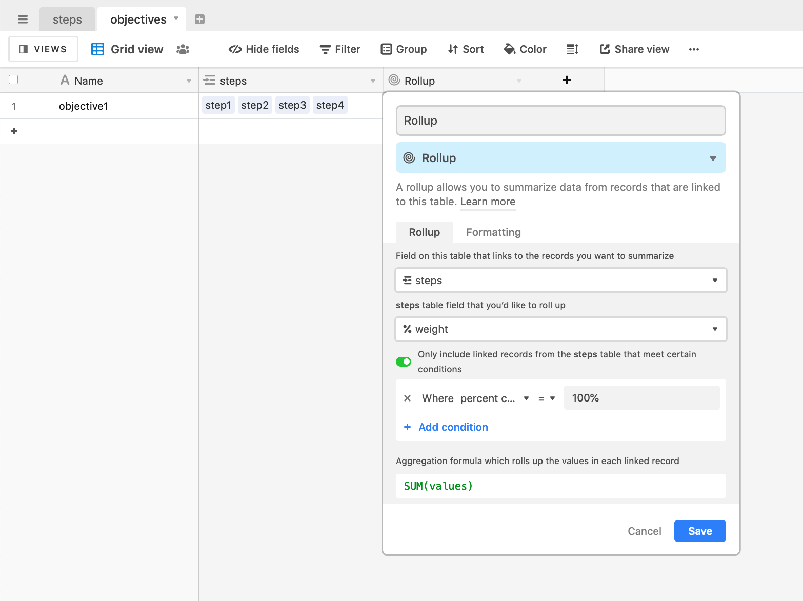

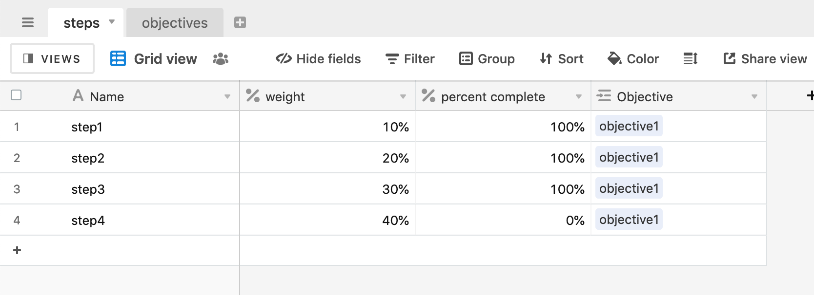

If I’m understanding correctly, you can use a Rollup field for that (same field type as ‘Objective Team’). The solution below isn’t totally correct, but hopefully it demonstrates the idea. I’m cheating a little by only counting weights that are 100% complete. A better solution would probably involve a third percentage column (a formula field) that combines weight with percent complete.

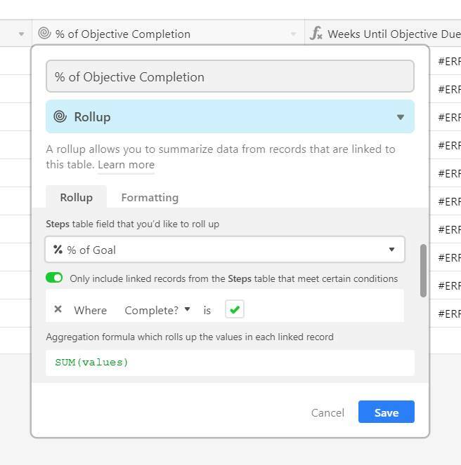

Got it!
Thanks for the help!!
