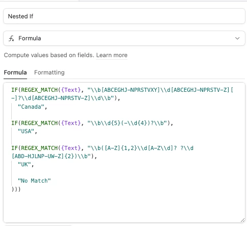

Best answer by BuildForAT
Hey ​@nroshak,
I’ve definitely had frustrating moments dealing with hard-to-manage nested if statements as well!
You’re right the Airtable’s SWITCH() statements won’t work for your case.
Unfortunately, Airtable doesn’t have the equivalent of Excel IFS() but I’ve found that formatting my If statements like so have been helpful
I keep the condition unindented, the output indented and you can add some white space to separate things out. The number of brackets at the end matches the number of IF functions used as well.
Definitely not as easy as using IFS() but this is the best I got, sorry!
BuildForAT
  • Jul 1, 2025 10:28 PM UTC
Hey ​@nroshak,

Honestly, this helps, thanks! Also thanks for confirming there is no IFS() equivalent.
