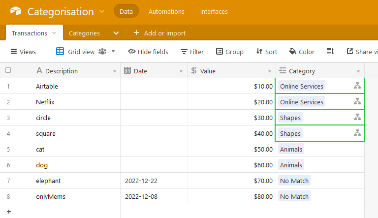

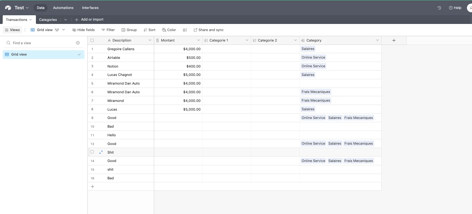

With a transactions table, and a Categories table - you can have a script match a Transaction Description against a Category String Term, and then update that transaction with that category upon having a match.
I wrote this with this mornings coffee, it seems to work - you can see the automation filling in the matched Categories;

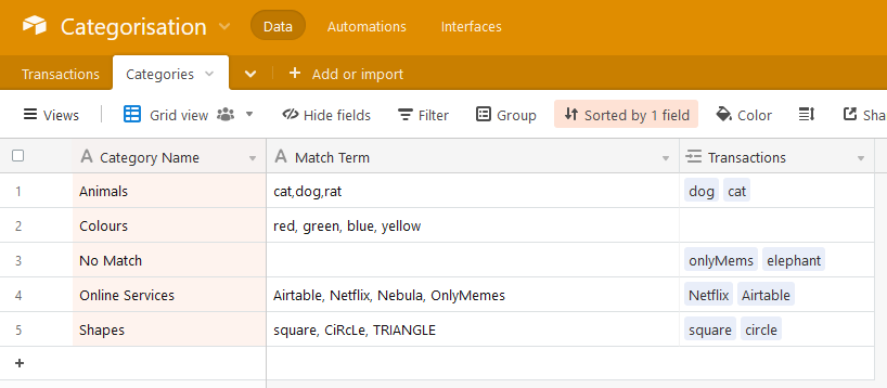

The match term is found within the Categories Table;

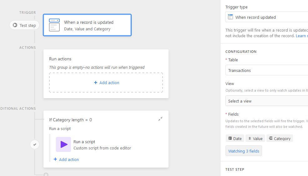

The automation triggers upon the Transaction Table being updated - it could probably be further refined;

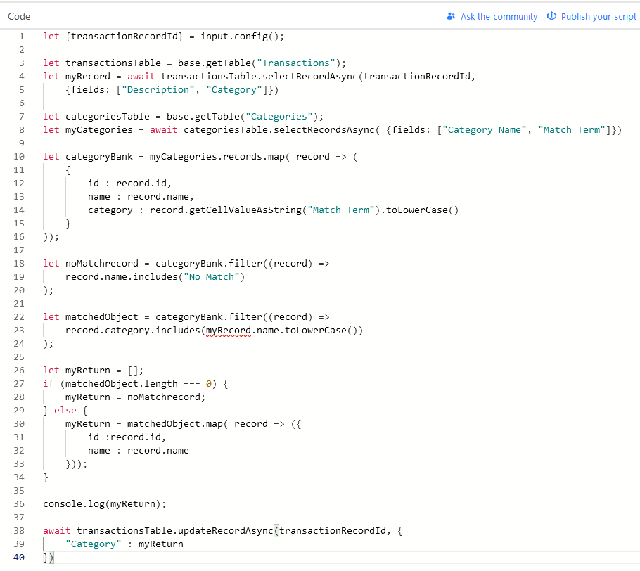

The tricky bit is the scripting, where you'll need a solid understanding with arrays, objects, and what data the Airtable API expects. There are many ways to do this task.
Unfortunately I have to paste my script as an image due to a bug in the new Airtable forums - typing it out is good practice.
Hopefully this helps! I plan to implement this into my own systems now I've figured it out.

When faced with this issue I ended up creating a script that would check whether the text included any specific words, and I output stuff from there
For example, if the text contains any of "wix", "squarespace", "airtable", it would output the word "Subscriptions" for me
You'd have to manually categorize everything but eventually you get to a point where you've covered most of them anyway and / or get too lazy to keep it up (which is what happened to me heh)

Hopefully this posts OK - the recent community forum updates introduced some bugs that have been making it difficult to post.
let {transactionRecordId} = input.config(); let transactionsTable = base.getTable("Transactions"); let myRecord = await transactionsTable.selectRecordAsync(transactionRecordId, {fields: ["Description", "Category"]}) let categoriesTable = base.getTable("Categories"); let myCategories = await categoriesTable.selectRecordsAsync( {fields: ["Category Name", "Match Term"]}) let categoryBank = myCategories.records.map( record => ( { id : record.id, name : record.name, category : record.getCellValueAsString("Match Term").toLowerCase() } )); let noMatchrecord = categoryBank.filter((record) => record.name.includes("No Match") ); let matchedObject = categoryBank.filter((record) => record.category.includes(myRecord.name.toLowerCase()) ); let myReturn = []; if (matchedObject.length === 0) { myReturn = noMatchrecord; } else { myReturn = matchedObject.map( record => ({ id :record.id, name : record.name })); } console.log(myReturn); await transactionsTable.updateRecordAsync(transactionRecordId, { "Category" : myReturn })

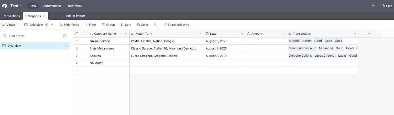

Hello Karlstens
This discussion came back up in my mails, so having a look at it again 😉

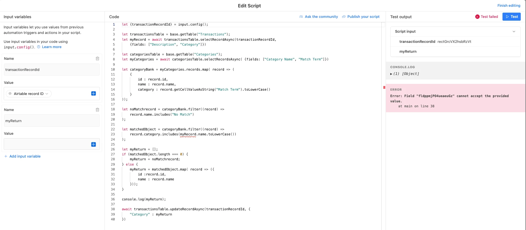

Fact 1 : no proper solution so far. I have sorted out a very heavy automation but not satisfying
Fact 2 : i tested your code, and for a reason I dont get, it only partially works as 1/ I cant get the 'No Match' printed in the required field when there is no match, and 2/ some times a word gets several answers despite not being in any single category (see attached with the word 'Good')
On top of this, I might need to ask for exact (or quasi exact) match to be valid, otherwise the risk is definitely to match wrong things together.
Happy to chat if ever you have  any brilliant idea, given you're way better than me on these matters 😂
