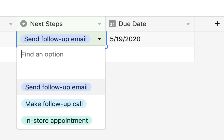

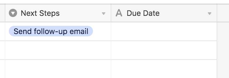

Hi! I’m trying to set up a CRM for some of our sales people and I’d like to auto-populate a ‘next step’ due date based on the selection they make for their ‘next step’. For example, if they select their next step as ‘Send follow-up email’, I want the due date to auto-populate for 2 weeks from when they entered the information. Or if they select their next step as ‘Place follow-up phone call’ I want the due date to instead auto-populate as 3 days from when they entered the information. Is this possible at all with a formula or would this require an external zap maybe in Zapier? Thanks in advance!

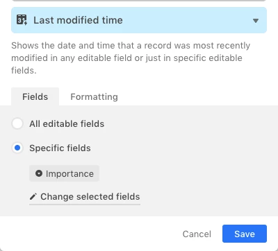

This could be possible with native Airtable fields, but only if the {Next Steps} field is set once at the creation of the record, and does not change after that; or else if you are ok with the {Due Date} field updating any time the {Next Steps} field is changed.
If that is the case here, then here’s how I think you could accomplish this:
  • Create a “Last modified time” field type, and select the “Specific fields” option, set to watch only the {Next Steps} field:
  • That will capture the date when the {Next Steps} field is set or changed

This worked BEAUTIFULLY! Thank you!!!
