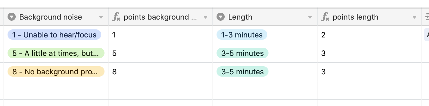

I have a table with multiple single select columns. Each single select column generates a numerical value, through a switch formula. I want to average the numerical values for each switch formula column. When I average the columns out now, I get back NaN.

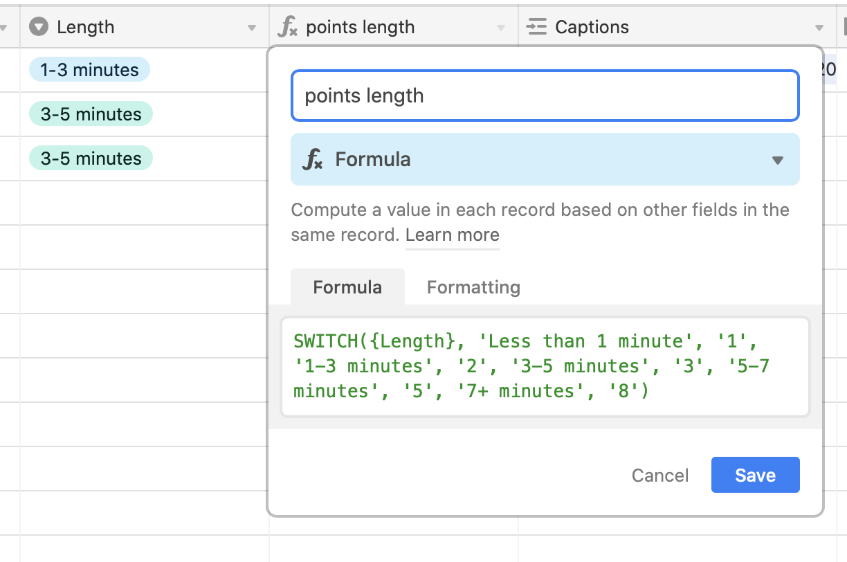

Here are examples of my switch formula columns:
Is there a way to do this?

Your switch formulas are return strings instead of numbers. Remove the quotes around the numbers in the switch formula so that the formula returns numbers.
SWITCH({Length},
  'Less than 1 minute', 1,
  '1-3 minutes', 2,
  '3-5 minutes', 3,
  '5-7 minutes', 5,
  '7+ minutes', 8

This Airtable newbie is very grateful that it was a quick fix - thank you! :slightly_smiling_face:
