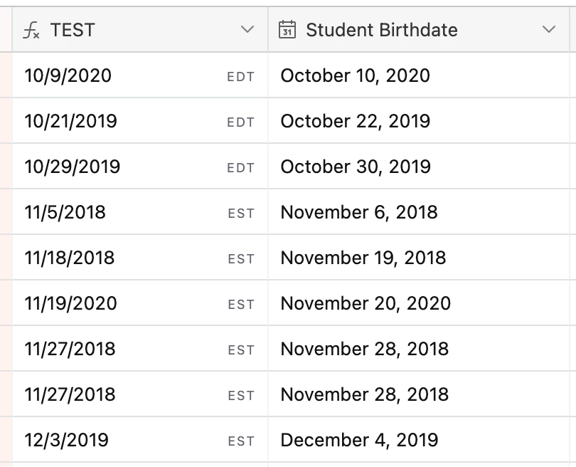

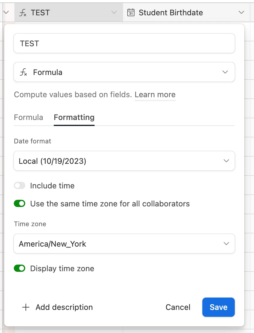

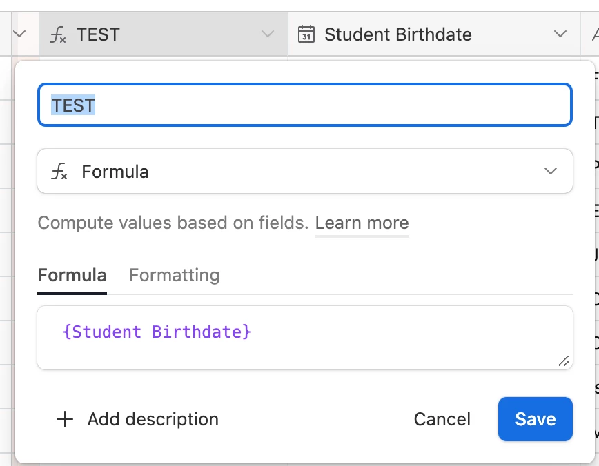

OK, here's some additional curious behavior. Here's a TEST column derived from the submitted dates, the formula is just {Student Birthday} so it should just be a passthrough — and the field is set to show everything in the same timezone for everyone.
The curious thing is that some dates show up as EDT, and some as EST. Which means perhaps whether daylight savings was active at the time the form was submitted is somehow stores along with the original date?? And that hour could kick some dates into the wrong day when we display them later?
  • October 19, 2023
(Also, to clarify, the dates in the TEST column are actually wrong by *2 days*, the real issue is that the dates in the Student Birthdate column are also wrong, by 1 day, and I have no idea why).

Thanks so much. Yeah I understand it's a field-level setting, but it doesn't seem like I have an option to display dates with a given timezone (only date+times). Is it possible this is glitching out because a given date (represented internally as a datetime) is somehow straddling the day boundary?
How does SET_TIMEZONE actually work? Does it actually shift the time from GMT->specified zone, or is it somehow "reinterpret casting" it?
It still makes no sense to me that the dates submitted on the form don't actually match the data in the "Student Birthday" field. Even if I don't do anything to it, the dates are wrong by a full day.
