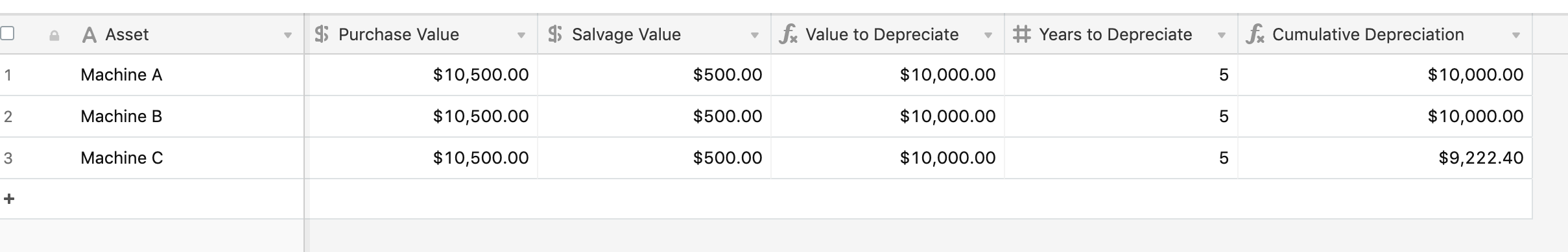

I tested out the Base where the assets had reached the end of their useful life, i.e. Age = Years to Depreciate - this was the result:
So, straight line and sum of years both fully depreciate the value. However, the double decline does not. I’m not sure if this is expected or if there’s some error in the formula (or if the formula should use different values for the depreciation calculation, e.g. “purchase value” rather than “value to depreciate”). Anyone with any knowledge in these matters?
