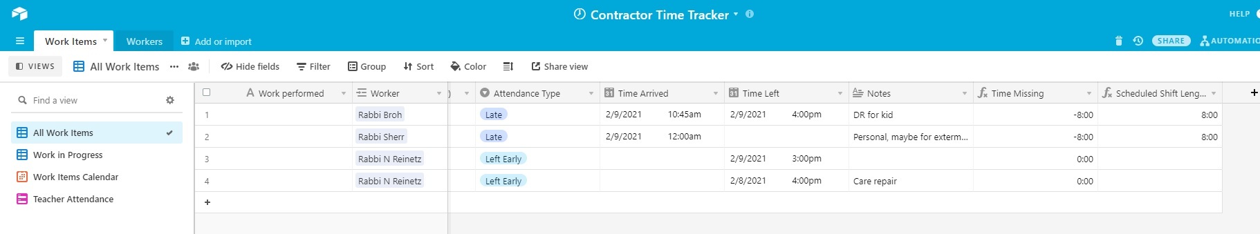

  • February 9, 2021
Thank you for all your help.
The formulas are working but not giving me the right calculation. What am I doing wrong?
Are you certain you related {Start Date} to {Time Arrived} and {End Date} to {Time Left} appropriately? Notice the order in which Start/End appear in the formula I gave.
