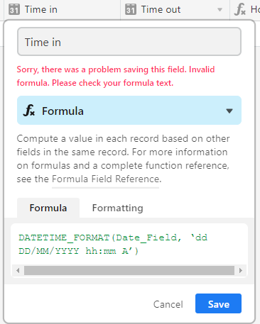

This did not work:
This did not work:
Check the single quotes surrounding the format specifier. When you copy/pasted @Andre_Zijlstra’s formula, you inadvertently picked up ‘pretty formatted’ matching inverted commas (‘’) instead of the required straight single quotes (''). Simply overwrite them with the single-quote character, which typically is the unshifted double-quote (") key found between the colon/semi-colon (:;) and Enter keys.
