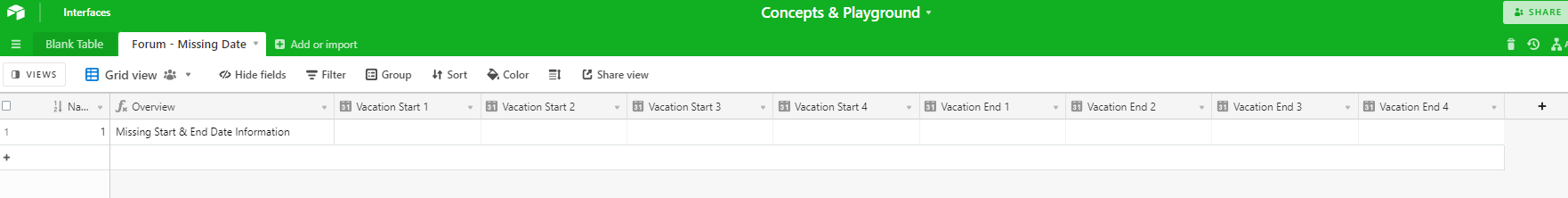

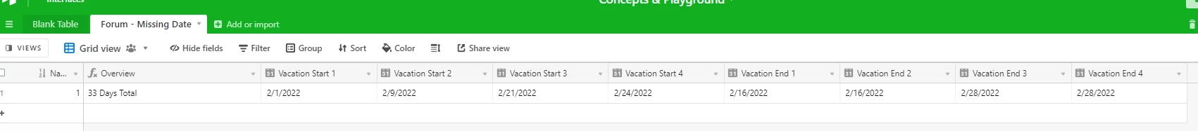

Here’s the final product:
When Filled In Correctly
Missing All Date Information (Both Start & End Dates)

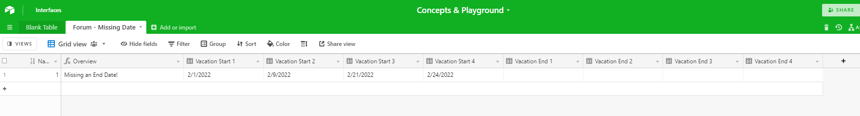

Missing End Date Data
To clarify past the screenshots, the formula doesn’t need to have all of the end or start date fields be blank for the messages to appear.
If all the fields are completed except for one end date, then the end date message will appear.
The same behavior is true for the start dates.
If you want to modify it a bit more, lemme know and I’ll walk you through how you can change things around to modify how it appears or logs information.
