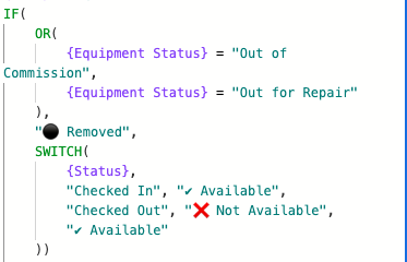

I'm not sure if what I'm trying to do is possible, but here goes:
I'm working off of an existing base template, and am trying to tweak one of the formulas that's in there. The existing formula is as follows:
I would like to add one additional condition: if Equipment Status is "Unknown" the result is
"❌ Not Available". Since this is pulling from a different field than the existing SWITCH formula, I can't add it in there; I've tried nesting another "If" within this formula, but that also doesn't seem to work. It may be that I simply can't do this, but if anyone has any ideas or suggestions, I'd appreciate it--I'm pretty new to Airtable formulas, and trying to figure out how best to leverage these formulas. Thanks in advance!

Hey @Eliz_Comm!
Here's the original formula from your screenshot:
IF( OR( {Equipment Status} = "Out of Commission", {Equipment Status} = "Out for Repair", ), "⚫ Removed", SWITCH( {Status}, "Checked In", "✔ Available", "Checked Out", "❌ Not Available", "✔ Available" ) )
In plain language, this formula looks at whether the Equipment Status field returns the value of "Out of Commission" or "Out for Repair".
If that expression evaluates true, the value of "⚫ Removed" is returned.
If that expression evaluates false, we default to a SWITCH function that evaluates the Status field values with a fallback value of "✔ Available."
Now, you'd like to add a conditional spike to this formula where the Equipment Status field is "Unknown", the formula should return "❌ Not Available."
There are a couple of possible permutations to this edit, but here's one way to do this:
IF( OR( {Equipment Status} = "Out of Commission", {Equipment Status} = "Out for Repair", ), "⚫ Removed", IF( {Equipment Status} = "Unknown", "❌ Not Available", SWITCH( {Status}, "Checked In", "✔ Available", "Checked Out", "❌ Not Available", "✔ Available" ) ) )

This worked perfectly--thank you so much!
