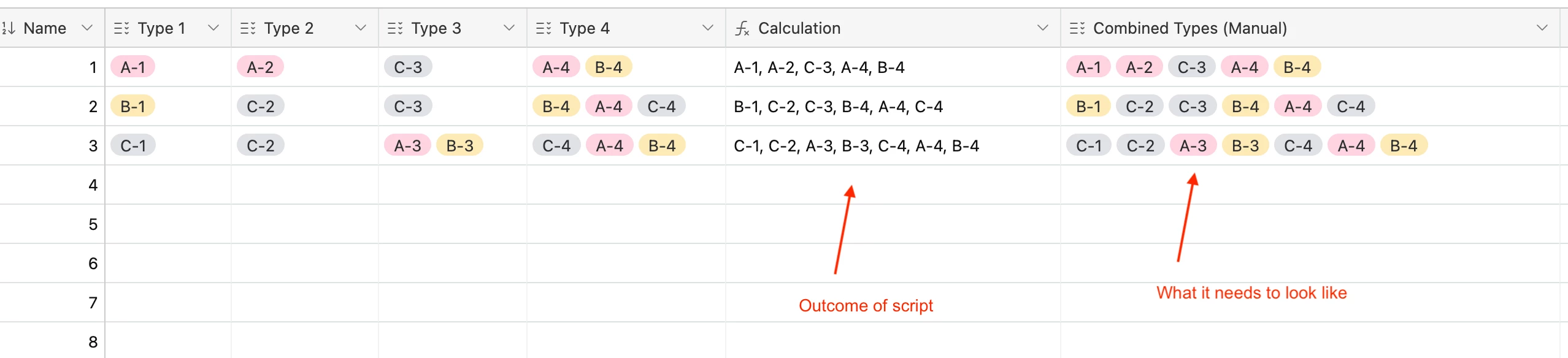

Hello. I'm struggling to find a way to combine the contents of several Multiple Select field into a new field, while retaining the value and color for each entry. Here's a stripped down version of what I'm trying to do:
I've got 4 separate multiple select field, each with their own set of options. The field called "Combined Types (Manual)" shows what I want the output to be. How can I aggregate all that data while retaining the color coding for each one? Thanks a lot.

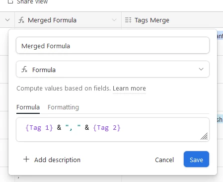

So as you're using a Formula Field to simulate the merged result, you could write a script that parses that Formula into an Object that can then update the Multi-Select field.

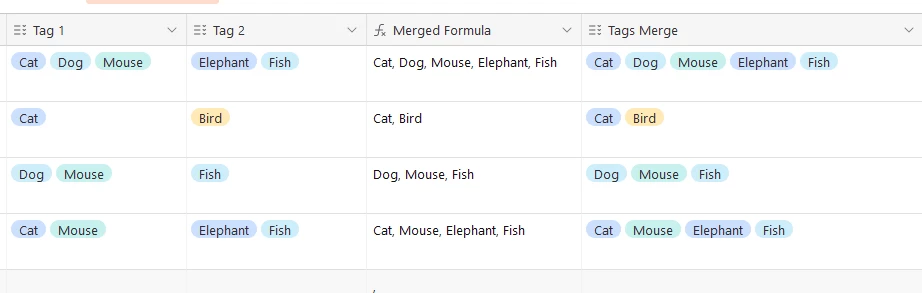

In my example, I have these fields "Tag 1" and "Tag 2" that contains animals.
I have a merged formula field, that takes those two fields values and concatenates them;
And within the Scripting App, I use this script to parse that "Merged Formula" column, and paste it into "Tags Merge". Note that my Table is called "Themes" - you'll need to change it to your table name.
let themeTable = base.getTable("Themes"); let themeRecord = await input.recordAsync('Pick a record',themeTable); if (!themeRecord) { console.warn("No theme found.") return } if (themeRecord) { output.text(`Processing Theme Data`); } let tags = themeRecord.getCellValue("Merged Formula"); let formattedTags = tags.split(", ").map( element => ( { name : element} )); let myRecordUpdate = { "Tags Merge" : formattedTags}; console.log(myRecordUpdate) await themeTable.updateRecordAsync(themeRecord, myRecordUpdate)

Using Scripting, I've been able to combine several multiple select fields into one as a string. But I can't figure out how to convert that string to another multiple select field

Thanks a lot! I used the Script Extension from this thread to create the formula:
REGEX_REPLACE(SUBSTITUTE(SUBSTITUTE(IF({Type 1}, ARRAYJOIN({Type 1}) & ",") &IF({Type 2}, ARRAYJOIN({Type 2}) & ",") &IF({Type 3}, ARRAYJOIN({Type 3}) & ",") &IF({Type 4}, ARRAYJOIN({Type 4}) & ",") , ", ", ","), ",", ", "), ", *$", "")

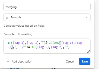

Thank you, Karlstens. Your answer really helped)
Here is an updated formula for a merging cell. Here we added a check for the case when one of the cells to be merged is empty.
IF({Tag 1},{Tag 1},"")& IF(AND({Tag 1},{Tag 2}),", ","")& IF({Tag 2},{Tag 2},"")
