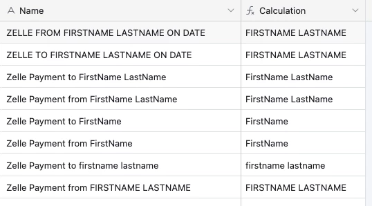

Hi Airtable folks,
I’ve got this really fun bookkeeping base I’ve created, which I use in conjunction with Fintable.io (a way to push bank transactions into Airtable – highly recommend!). Since Fintable downloads the transaction names from my bank statements in all sorts of different ways depending on how the banks format them, I wanted to create a formula to extract the Vendor name from when I receive or send money through Zelle. The thing is that this can show up in a variety of ways:
ZELLE FROM FIRSTNAME LASTNAME ON DATE
ZELLE TO FIRSTNAME LASTNAME ON DATE
Zelle Payment to FirstName LastName
Zelle Payment from FirstName LastName
And so on…
What I’m getting stuck on is how to combine two formulas I ended up creating: one that returns both the first name and last name of the person (but when there is no last name, returns some of the random extra characters after the first name), and one that returns only the first name, whether there is a last name or not present in the transaction name. For the life of me I couldn’t find a way to nest these two together! So I ended up creating two separate formula fields, and a third one that checks when one of the two contains numerals (meaning that record has a first name only, and that formula accidentally grabbed extra characters after the name), so it can return the results from the first-name-only formula. It works, but it feels very roundabout and inefficient. Anyone willing to help me put them together? Full disclosure: I started these on my own but used a bit of AI help to develop them, which is why some aspects of them work but I can’t quite decipher them on my own to solve my issue. Formulas below:
Zelle Formula 1:
IF(FIND("ZELLE FROM", {*Name}&""), MID({*Name},12,(FIND(" ON", {*Name})-12)),
IF(FIND("ZELLE TO", {*Name}&""), MID({*Name},9,(FIND(" ON", {*Name})-9)),
IF(FIND("Zelle payment to", {*Name}&""),

Thanks for the help!

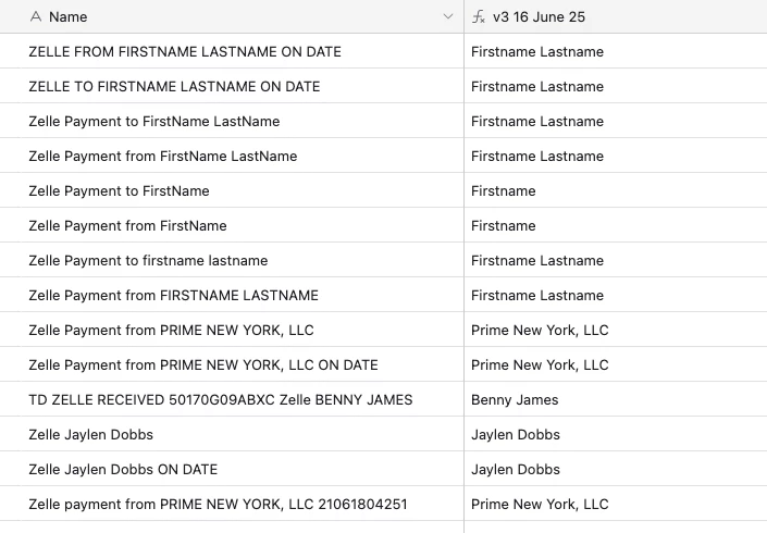

Forum|alt.badge.img+9
  • June 12, 2025
Thanks so much for the responses! ​@TheTimeSavingCo, yes, that’s what I was looking for! Your formula worked in most instances, but I ran into a couple of hiccups:
  1. it’s not often, but sometimes the vendor name is three+ words long (example: Zelle payment from PRIME NEW YORK, LLC), and in such cases only the two names show up (“PRIME NEW” in this case).
  2. I found another weird instance where things are formatted like this: “TD ZELLE RECEIVED 50170G09ABXC Zelle BENNY JAMES” and I assume because it says Zelle twice, the formula throws an error.
  3. It also throws an error when the formatting is: “Zelle Jaylen Dobbs“ (FYI these names are all made up, don’t worry!)
I guess I hadn’t identified EVERY SINGLE way Zelle transactions can possibly be formatted, though I did try to think of most options.
Also, I’m wondering if there’s a way to include in the formula a standardized capitalization for the results (I’d love to have the first letter of each word uppercase, and the rest lowercase if possible)?
You’ve already helped so much just with what you gave me, so no pressure to work on this any more, I really appreciate the input you’ve given. Just thought I’d throw it out there in case anyone wants to trty, and if it’s helpful for other folks.

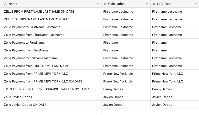

No worries!  How does this look?
The LLC isn’t formatted properly, but I figure you can fix those by putting a ‘SUBSTITUTE’ on top.  It’ll all have to be hardcoded, but there shouldn’t be that many of these I reckon
I found the formula for capitalizing the first letter of each word here (standing on the shoulders of giants etc heh)
SUBSTITUTE(
REGEX_REPLACE(REGEX_REPLACE(REGEX_REPLACE(REGEX_REPLACE(REGEX_REPLACE(REGEX_REPLACE(REGEX_REPLACE(REGEX_REPLACE(REGEX_REPLACE(REGEX_REPLACE(REGEX_REPLACE(REGEX_REPLACE(REGEX_REPLACE(REGEX_REPLACE(REGEX_REPLACE(REGEX_REPLACE(REGEX_REPLACE(REGEX_REPLACE(REGEX_REPLACE(REGEX_REPLACE(REGEX_REPLACE(REGEX_REPLACE(REGEX_REPLACE(REGEX_REPLACE(REGEX_REPLACE(REGEX_REPLACE(REGEX_REPLACE(REGEX_REPLACE(REGEX_REPLACE(REGEX_REPLACE(REGEX_REPLACE(REGEX_REPLACE(REGEX_REPLACE(REGEX_REPLACE(REGEX_REPLACE(REGEX_REPLACE(REGEX_REPLACE(REGEX_REPLACE(REGEX_REPLACE(REGEX_REPLACE(REGEX_REPLACE(REGEX_REPLACE(REGEX_REPLACE(REGEX_REPLACE(REGEX_REPLACE(REGEX_REPLACE(REGEX_REPLACE(REGEX_REPLACE(REGEX_REPLACE(REGEX_REPLACE(REGEX_REPLACE(REGEX_REPLACE(
TRIM(
REGEX_EXTRACT(
LOWER({Name}),
"(?:zelle.*?zelle|zelle(?: payment)?(?: from| to)?)\\s+(.+?)(?:\\s+on\\s|$)"
"^a", "A"), "^b", "B"), "^c", "C"), "^d", "D"), "^e", "E"), "^f", "F"), "^g", "G"), "^h", "H"), "^i", "I"), "^j", "J"), "^k", "K"), "^l", "L"), "^m", "M"), "^n", "N"), "^o", "O"), "^p", "P"), "^q", "Q"), "^r", "R"), "^s", "S"), "^t", "T"), "^u", "U"), "^v", "V"), "^w", "W"), "^x", "X"), "^y", "Y"), "^z", "Z"), " a", " A"), " b", " B"), " c", " C"), " d", " D"), " e", " E"), " f", " F"), " g", " G"), " h", " H"), " i", " I"), " j", " J"), " k", " K"), " l", " L"), " m", " M"), " n", " N"), " o", " O"), " p", " P"), " q", " Q"), " r", " R"), " s", " S"), " t", " T"), " u", " U"), " v", " V"), " w", " W"), " x", " X"), " y", " Y"), " z", " Z"),
', Llc',
', LLC'

Thank you, ​@TheTimeSavingCo for taking another stab at this! What’s happening now is that across the board whenever there is anything following the names (usually a bunch of random characters) those get added in too… eg”Zelle payment from PRIME NEW YORK, LLC 21061804251” becomes “Prime New York, LLC 21061804251” and “Zelle Payment to Pete Wilson 23648791677” becomes “Pete Wilson 23648791677”. Is there a way to dynamically filter that out? That was sorta the original issue I set out to fix, and I hadn’t known a way to clip those other than using LEN( and the left/right functions, but it was clunky. I don’t really know much about Regex functions so I’m a bit lost here…
Honestly, most folks in my use cases have first name and last name only, so if I had to cap it at two words I’d be ok (or maybe there’s a way to take all words before an “,LLC” or something like that, which would take care of longer company names?). I was just trying to avoid the random characters that come along when the system is set up to grab first and last name, and there happens to only be a first name, which happens sometimes.
Thanks again for the help!
