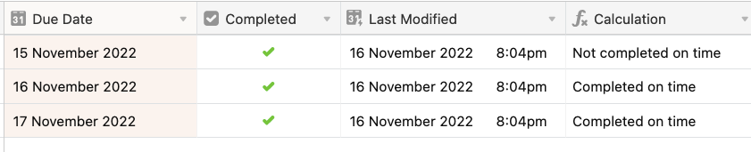

Hi, Adam!! Thanks for your reply =]
I guess I wasn’t clear in my post, so I’m sorry for that. This way you made is one of the ways I tried. Is there anyway we could do this considering only the date and not the time?
Just to clarify, I’m using 1 and 0 as a return because it will be used in an automation and will be an easier parameter to insert there, but logic is the same or am I missing something?
Hi Aline! I’m so sorry, you were perfectly clear in your post, I misunderstood you
I’ve updated the original base:
And this is the new formula:
  IS_BEFORE(
    {Last Modified},
    DATETIME_PARSE(
      DATETIME_FORMAT(
        {Due Date},
        "DD MM YYYY"
      ) & "2359",
      "DD MM YYYY hhmm"
  "Completed on time",
  "Not completed on time"
I think this should be right?

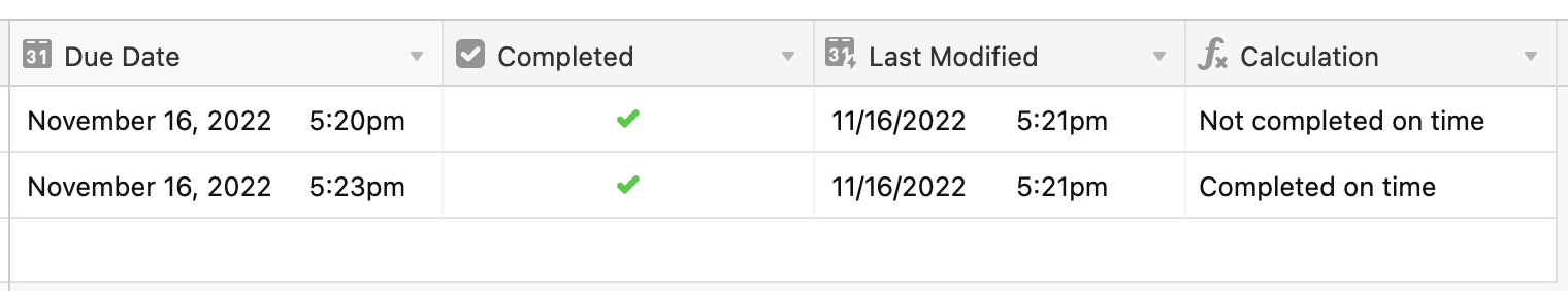

Hi Aline, I’ve set something up here for you to check out that may help
The formula in use is:
  IS_BEFORE({Last Modified}, {Due Date}),
  • November 16, 2022
  IS_BEFORE(
    {Last Modified},
    DATETIME_PARSE(
      DATETIME_FORMAT(
        {Due Date},
        "DD MM YYYY"
      ) & "2359",
      "DD MM YYYY hhmm"

Perfect, Adam!! You nailed it!
It’s cleaner and finally working properly. Thank you very much for your help!
