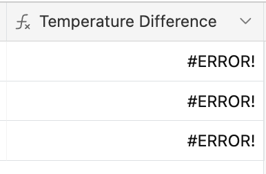

In another field {Temperature Difference} I want to calculate the number of degrees above a fixed temperature with a formula like this:
{First Temperature Reading} - 20
This displays an error and all values are 1.0 (following the results format I set). However the Preview result is "true", so 1=true. Removing the "-20" I can not set the result format and get the message "Your result type is not a number or a date. Formatting options are currently only available if your result type is a number or a date."

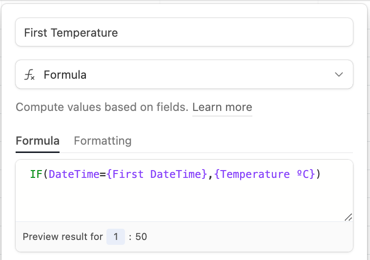

Tracing it back, my temperature reading stopped being a number in {First Temperature} when I used the formula:
IF(DateTime={First DateTime},Temperature, '')
My assumption is that because the formula returns two different types, a number, and whatever '' is, therefore the fields type is unclear, and this unclear status is kept all through the transformations until it arrives in my formula in the Experiments table.

Best answer by Alexey_Gusev
try to:
1) remove ''  (just close bracket after Temperature)
2) use VALUE({some_result}) for explicit conversion to number

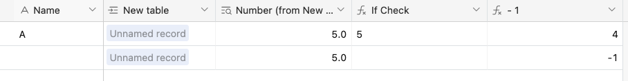

Hm, could you share a read only invite link to an example base with this issue so I can take a look at it for you?  I tried to replicate it but wasn't able to:
Link to base
  • April 16, 2024
https://airtable.com/apppjm1dbpSM2JxEZ/shrj5isDBs9RJMEbC
Sorry for not thinking of that earlier!

try to:
Hi Alexey,
Thank you very much! Suggestion (1) fixed it.

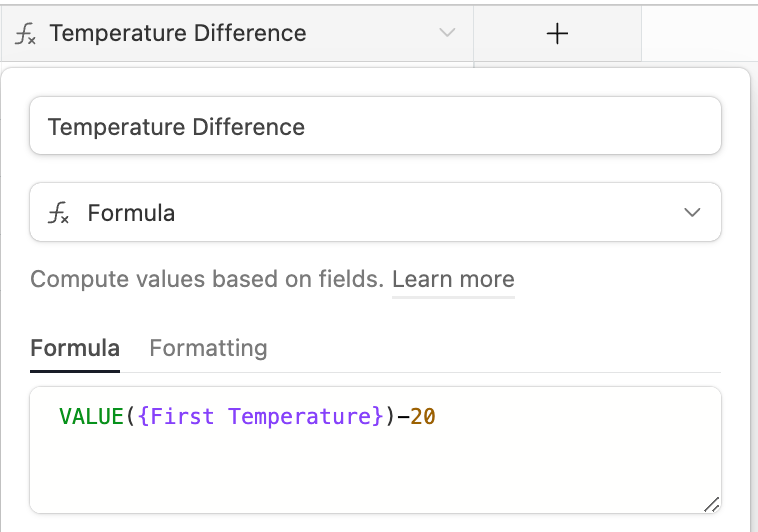

I tried (2) as well, without (1), and all that produced was an error, which is confusing.
Alexey_Gusev
Forum|alt.badge.img+25
Hi Alexey,
glad it helped you! It was just a quick guessing, like 'try 1, OR try 2'
If after (1) it is OK, then just ignore (2)
For your info, about 2, I suppose {First temp} you using is lookup. All lookups are arrays, even when empty or single-value. I think, Airtable math expressions can use a single value array as number (and it surprised me), but VALUE function - not, It needs string.
Array can be converted to string by CONCATENATE({Field}) or {Field}&''. So, VALUE({Field}&'') will do the job. Maybe ))
But if it works without extra functions, I think you should leave it 'as is'.
Thank you. It's good to understand better how arrays and VALUE work.
On (1) I had tried, removing '' from the formula but had left the trailing comma so that the function ended ,) which it didn't like. I didn't think to try dropping the last argument altogether! New trick unlocked.
