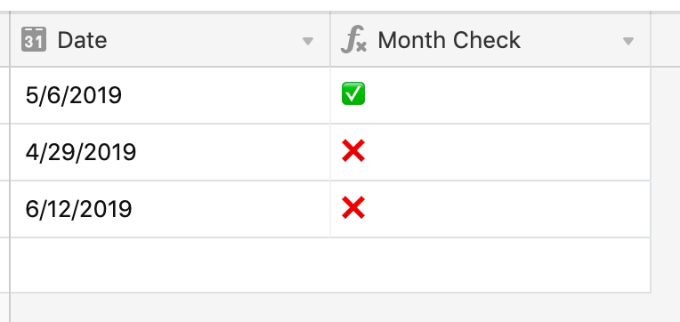

I am trying to pull a value from a field of a record if the date field is the current month. Does anyone know of a formula that does this
JonathanBowen
@Joshua_Owen - I’m guessing you want to check that the date field matches the current month and year, not just the month. If so, you could use the formula:
IF(DATETIME_FORMAT(Date, 'MM/YYYY') = DATETIME_FORMAT(NOW(), 'MM/YYYY'), '✅', '❌')
(but you can easily mod this if you do just want to check that the month is the current month - just remove the YYYY from both sides)
