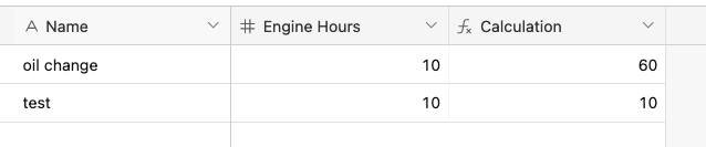

I'm not entirely sure what you're doing, but I used the following formula to get this result:
IF( FIND( "oil change", LOWER(Name) ), {Engine Hours} + 50, {Engine Hours} )

Having a problem accepting
LOWER(Name)
 What should "name" be?
