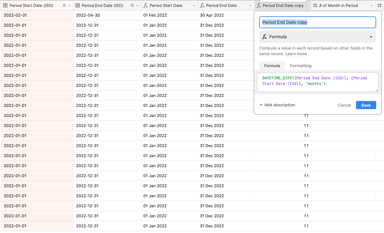

Dear Community,
Need help in trying to calculate the difference in months and days between two dates.
Q1: is it even possible to calculate difference and return result in month and days? Or is it only possible in either months OR days?

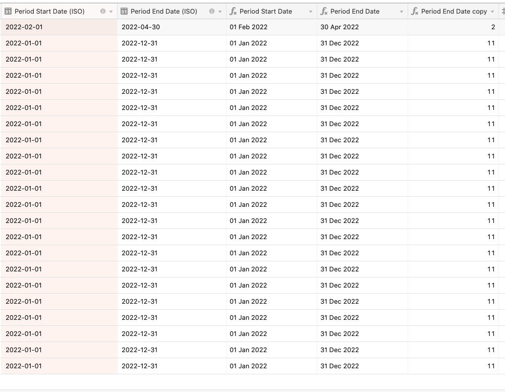

Q2: I entered a formula to only display difference in months, but choosing Jan 1 to Dec 31 is showing 11 months, and not 12 months. I get it that is subtracts and does not include Dec 31 in it’s calculation, but selecting the employement period dates (in our case) to be Jan 1 to Jan 1 would technically create confudion to the employee, as the period ends Dec 31. Any work around this. Super thanks in advance.
Best answer by Khuned_Sachdev
Hi @Khuned_Sachdev
You could use this formula to add 1 day and get 12 months:
DATETIME_DIFF(DATEADD({date end}, 1, "days"), {date start}, "months")
Hi @Databaser, just used this and it works perfect! Thanks.

Hi @Khuned_Sachdev
Forum|alt.badge.img+9
Hi @Khuned_Sachdev
Dear @Databaser Thanks lots. I think that shall solve the number of months issue.
