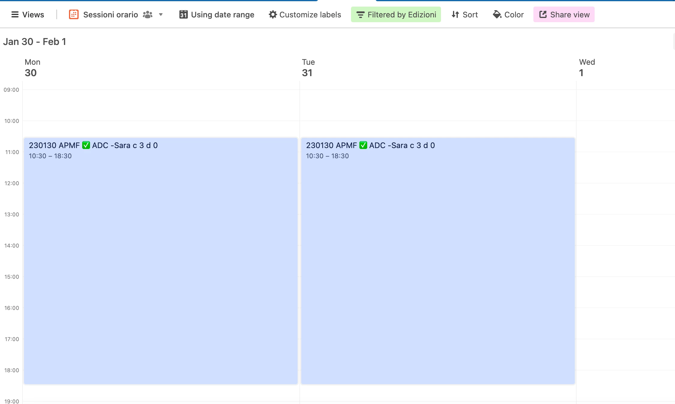

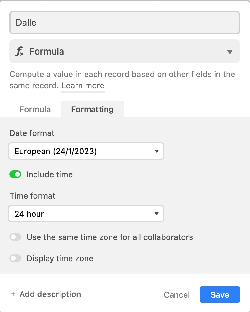

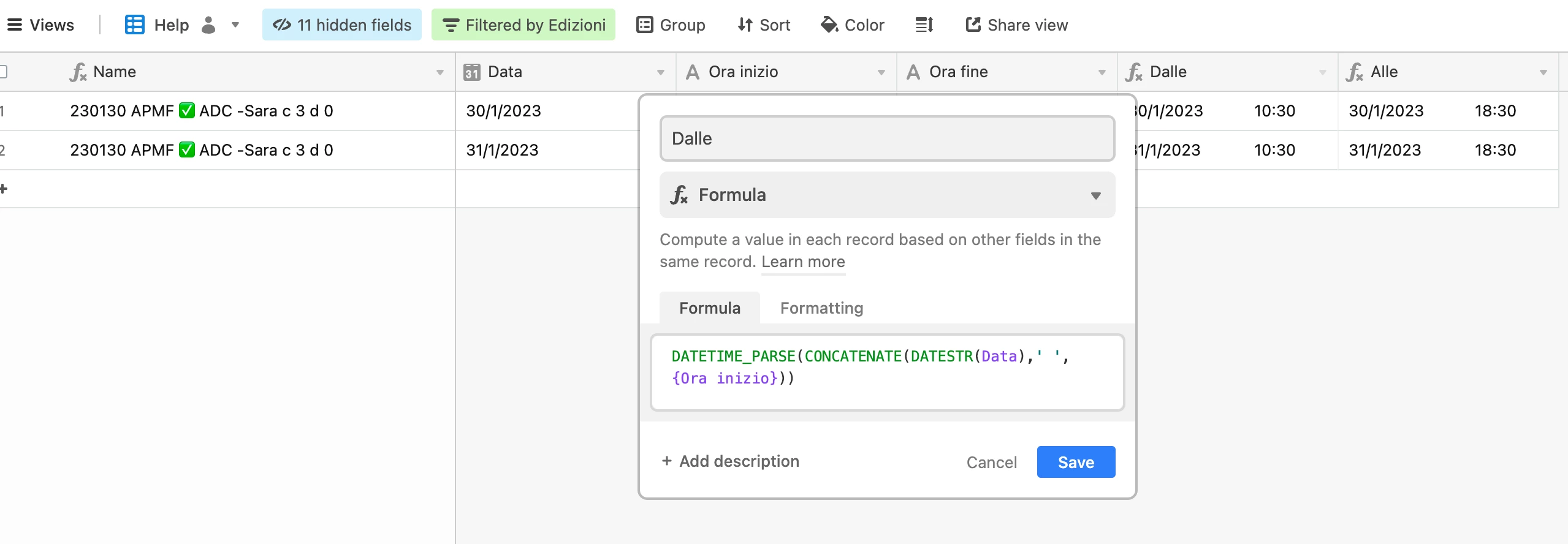

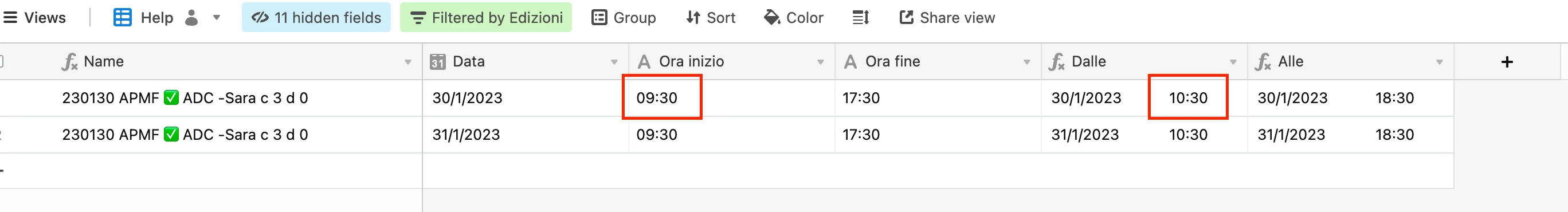

I have to create a calendar of course sessions and I have a table in which I enter in one column the date, in one column the start time and in another column the end time because different days might have different times.
I use the formula DATETIME_PARSE(CONCATENATE(DATESTR(Date),' ',{Start Time})) to create a date & time that can be displayed on the calendar. However, the result of the formula returns the wrong time, increased by one hour.

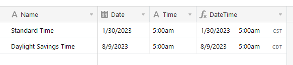

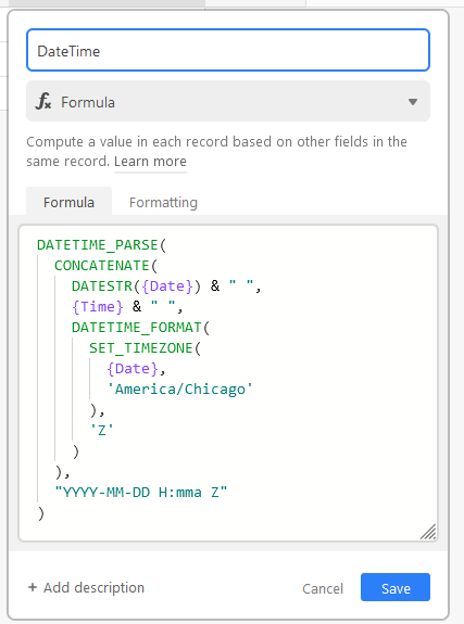

  • Jan 25, 2023 11:28 PM UTC
Thank you for looking up the thread on timezones. I played around a bit more. Note that I am in the USA in "Central" time. Your formula will be slightly different since you use a 24 hour clock instead of am/pm, and you are in a different timezone.
