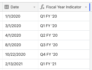

Sorry. I was a bit hasty in my writing of that formula. All of the OR() functions should be AND() instead. I changed the formula above to reflect that. It will output the correct quarters now.
Also remember what I said above my formula (emphasis added):
I had intentionally only tacked the quarter indicator while waiting for your clarification re: the fiscal year.
Because you’re not offsetting the fiscal year from the calendar year, the latter part of the formula can also be greatly simplified. Here’s the full formula to create the output you seek:
IF(AND(MONTH(Date) >= 1, MONTH(Date) <= 3),"Q1",
IF(AND(MONTH(Date) >= 4, MONTH(Date) <= 6),"Q2",
IF(AND(MONTH(Date) >= 7, MONTH(Date) <= 9),"Q3",
IF(AND(MONTH(Date) >= 10, MONTH(Date) <= 12),"Q4"))))
& " FY '" & RIGHT(YEAR(Date) & "", 2)
