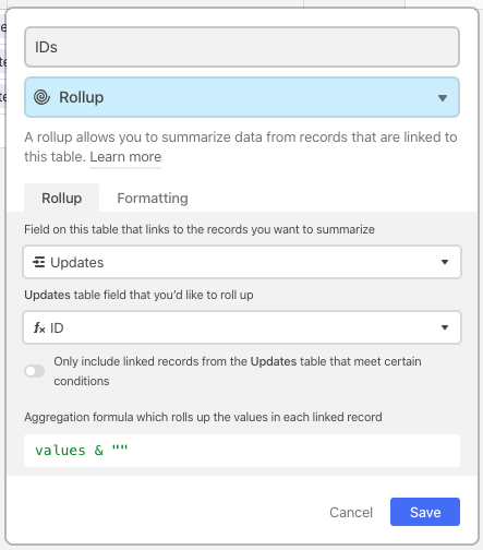

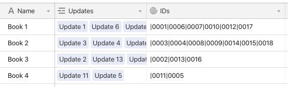

In the [Books] table, add a rollup field named {IDs} that rolls up all of those IDs based on the links to their updates.

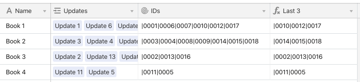

Now determine how many updates you want to see. Let’s say you choose 3. Make a formula field in [Books] with the following formula:
RIGHT(IDs, MIN(LEN(IDs), 15))
This will grab the rightmost 15 characters (3 IDs of 5 characters each) from the mashed up ID list. If there aren’t that many characters to grab, it will grab what it can.

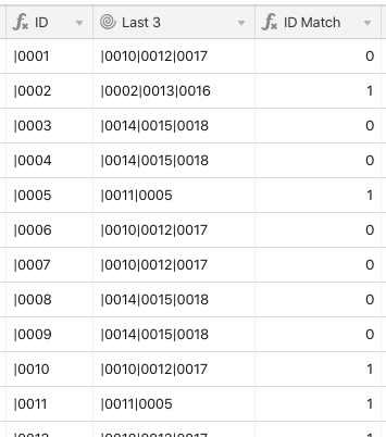

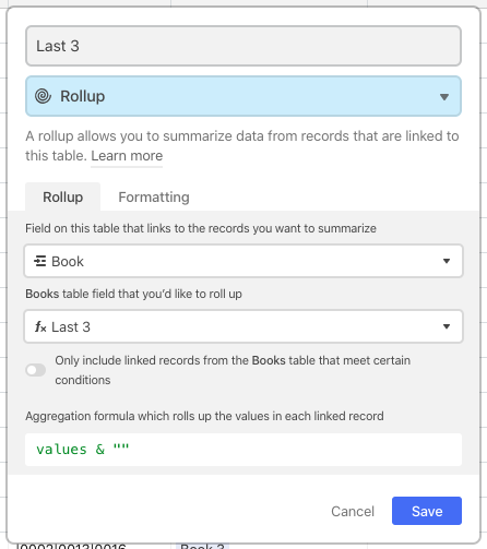

Back in [Updates], make a rollup field to bring in the value from this {Last 3} field:
Add a formula field named {ID Match} using the following formula:
FIND(ID, {Last 3}) > 0
That will return a 1 for any update record that’s part of that list of the last 3 for its associated book, and a 0 for all other fields. The leading bar before each number helps to delineate where each number begins; without it, a false match might be found between adjacent numbers. It’s also possible to use the default comma separation between numbers when building the initial rollup string, which makes the leading bar unnecessary. Either way works fine.
Finally, make a new view named “Last 3 Updates”. Add a filter to this view that only shows records where {ID Match} contains a 1. This will only show the last 3 updates for each book. Group by book and sort by date to so that updates for each book are easier to review.
