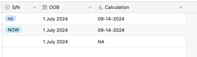

I need to calculate a date, in certain circumstances, that is 75 days out from another date in my table. I’m using this formula:
SWITCH({S/N}, 'no', DATEADD(DOB, 75, 'days'), 'NOW',DATEADD(DOB, 75, 'days'),'NA')
which calculates correctly, but includes a time stamp in the results (2024-07-24T00:00:00.000Z). What do I need to do to my formula to get the date only, in mm-dd-yyyy format? My apologies if this is covered somewhere else. I’m not finding exactly what I need in the guides or past posts to this forum.

Try this:
SWITCH( {S/N}, 'no', DATETIME_FORMAT( DATEADD( DOB, 75, 'days' ), 'MM-DD-YYYY' ), 'NOW', DATETIME_FORMAT( DATEADD( DOB, 75, 'days' ), 'MM-DD-YYYY' ), 'NA' )
I'm curious about the formula you have though; both "no" and "NOW" appear to be adding 75 days to the DOB.  Is that intended?

Yes, that's intended. Thank you so much for your help. I wouldn't have gotten that right on my own!
