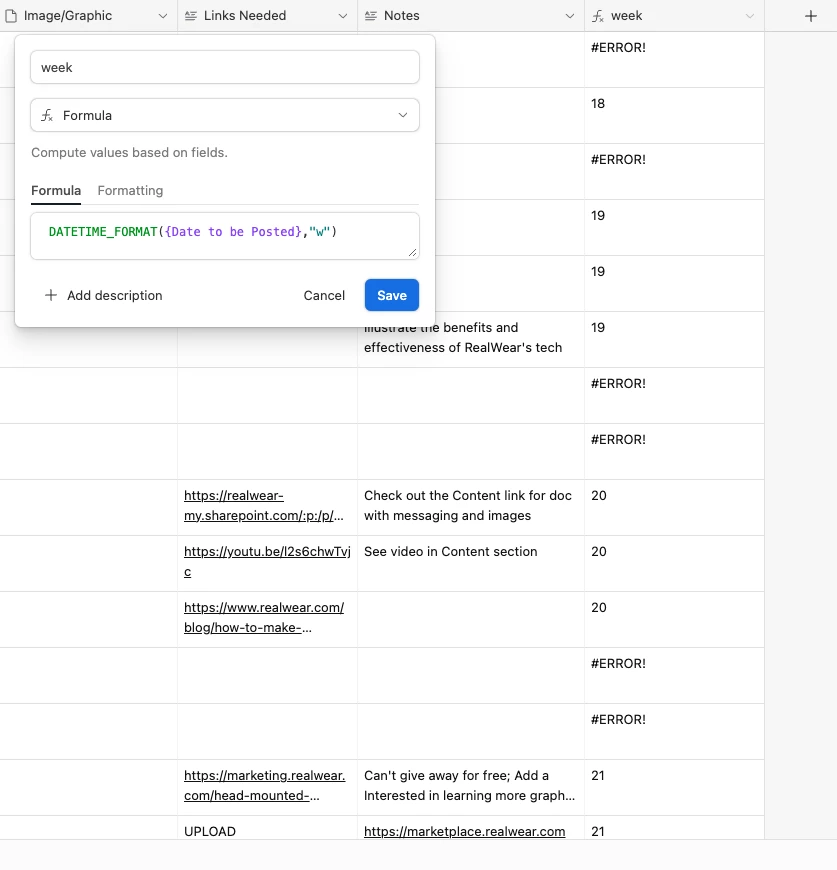

I have a field that shows the week of the year, but I break my records up sometimes by leaving some fields blank. How can I get rid of the #ERROR! message that is shown whenever there is no date (or week) in that field?
Here is the formula I use:
DATETIME_FORMAT({Date to be Posted},"w")

You can wrap your formula in an IF() that checks if Date to be Posted exists, returns your formula if it does and returns blank if it doesn't.
IF( {Date to be Posted}, DATETIME_FORMAT({Date to be Posted},"w"), BLANK() )

That worked! Thanks so much.
