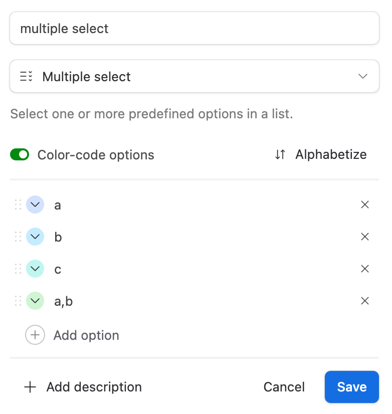

Of course I tried it.
Let me explain more visual way.
This is my multiple select:
You can see there are 4 options.

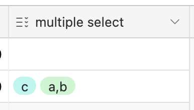

This is selection I want to check:
Hope this is more accurate description.

Ah, I see why the FIND function is not working.
Multi-select is difficult to process because it's just text.
How about this formula?
IF( AND( REGEX_MATCH("##"&REGEX_REPLACE({select},", ","##")&"##","##c##"), REGEX_MATCH("##"&REGEX_REPLACE({select},", ","##")&"##",'##"a,b"##'), LEN({select})=LEN('c, "a,b"') ) ,1 )
