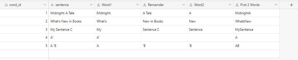

Here is the result that I get (column "first 2 words"):

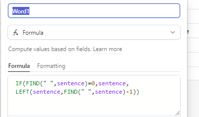

Formula "Word1" extracts the first word:

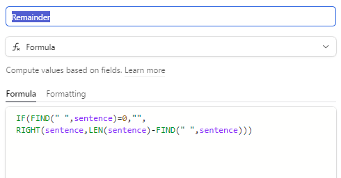

Formula "Remainder" extrats the rest of the sentence if it exists:

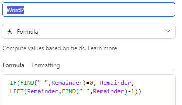

Formula "word2" extracts the second word from the remainder:

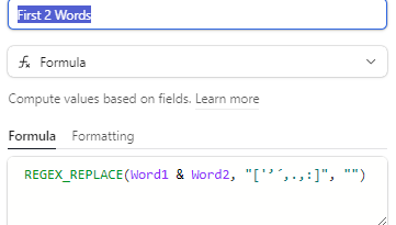

Formula "First 2 words" concatenates Word1 and Word2 and removes characters " ' "and " : " :
You will need to complete the REGEX_REPLACE function with all special characters that you wish to remove (as i did with the dot for example)

Thank you, Pascal, this worked perfectly! For others trying it, I did include an additional field to capitalize the second word before concatenating them.
