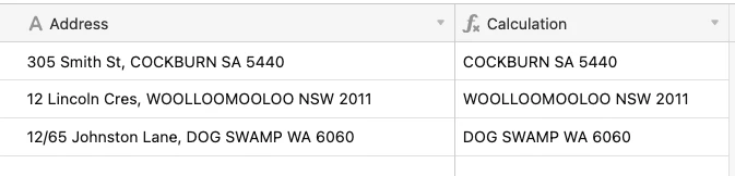

I need some help with extracting specific text. I've looked through the community and tried to apply the examples offered...but I am not getting it quite right.
I need to extract the suburb, state and post code from a (text) address field. Some suburbs are made up of two names. Below is an example of how the addresses are formatted/written.  Whilst the addresses are made up, these are real suburbs in Australia 😀.
Address Examples:
305 Smith St, COCKBURN SA 5440
12 Lincoln Cres, WOOLLOOMOOLOO NSW 2011
12/65 Johnston Lane, DOG SWAMP WA 6060
Wanted Outcome:
COCKBURN SA 5440
DOG SWAMP WA 6060
I appreciate the help. I don't expect an explanation but I am trying to learn so any info alongside the solution will be helpful.

Hm, if it's always going to be the text after the comma, you could try:
SUBSTITUTE( Address, LEFT( Address, FIND( ",", Address ) + 1 ), "" )
We use `FIND()` to get where the comma is in the text, then we use `LEFT()` to extract all the text before the comma, and then we use `SUBSTITUTE()` to replace it all with a blank

Thank you so much for your time and help. This was what I was after!
