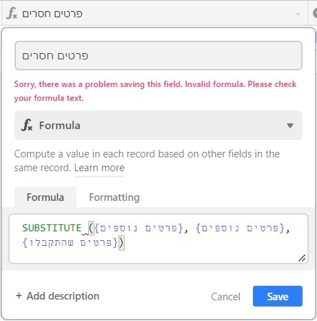

I have now corrected the formula
SUBSTITUTE ({more details}, {more details}, {details received})
Because I want to download from the “More Details” list the “Details Received”.
But it still does not work.

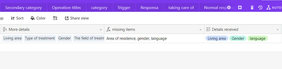

From the list of additional details:
“Area of ​​residence, type of treatment, gender, field of treatment, language”
I am interested in downloading the “details received” - area of ​​residence, gender, language
To get the missing details.
And the formula does not work for me.
I get in this formula the list of “details received” - area of ​​residence, gender, language
(And not the missing details)

The example text from your post doesn’t match the options I see in your screenshot so I just sorta guessed what you want.
If you use a formula like the one below, it will remove any option selected in the {Details received} field from the list in the {More details} field.
REGEX_REPLACE(
  {More details},
  SUBSTITUTE({Details received}, ", ", "|"),
^ that’s going to end up with some extra commas but confirm that it does what you’re looking for.
The reason I’m replacing commas with pipes is because in regex a pipe means “or”, so this method lets you replace multiple items with the same thing (in this case, that thing is “empty space”).
