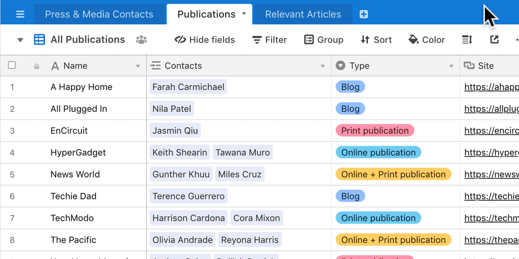

I have a column that is called Contacts that lives in table Publications. In this column, each cell has one or multiple linked records that can be found in another table called Press & Media Contacts.
A cell inside Contacts looks like this
What I would like to do is to filter and select the rows that have a certain contact in, using the record id.
The only way I could do this was to use filterByFormula and Name, not record id:
It sounds like you want to filter your publications by contacts, but you want to use their ID instead of their name as the filtering criteria.
What you’ll want to do is 3 things:
Create a “RecordID” field in your Contacts table by creating a formula field with the formula: RECORD_ID()
In your Publications table, create a lookup field that looks up this new “RecordID” field from your Contacts table.
Once you have this new lookup field in your Publications table, then you can filter on this lookup field by typing the RecordID into the filter.
