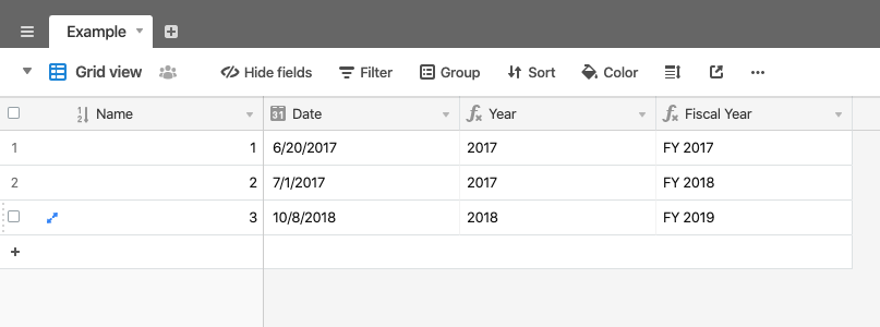

I recently had to figure out how to get the fiscal year from a date field. Surprisingly, there wasn’t an explanation and ‘copy and paste’ formula already on here (or I just couldn’t find it).
Here is my take on the challenge:
To use this -
  1. Make sure you have a date field to reference labeled ‘Date’.
  2. Add 2 new fields, one labeled ‘Fiscal Year’, and the other ‘Year’.
  3. Make the one labeled ‘Year’ a formula field and copy and paste the code below into the formula area.
    DATETIME_FORMAT({Date}, ‘YYYY’)
  4. Make the one labeled ‘Fiscal Year’ a formula field and copy and paste the code below into the formula area.
    IF(IS_BEFORE({Date}, DATETIME_PARSE(CONCATENATE(‘06-30’, “-”, Year))), CONCATENATE("FY ", Year), CONCATENATE("FY ", VALUE(Year)+1))
  5. That’s it!
The end of the fiscal year in this formula is June 30th. If you have a different year end, change the ‘06-30’ in the Fiscal Year formula.
I then hide the Year field and group by fiscal years. It is great for seeing historical trends.

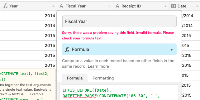

Thank you for this! I’m using it, but for some reason I’m getting an error. Any reason why that could be?
Actually, I figured out the problem - there was an extra spaced that was causing the error after the first FY. Thank you for this solution - it saved me so much time!

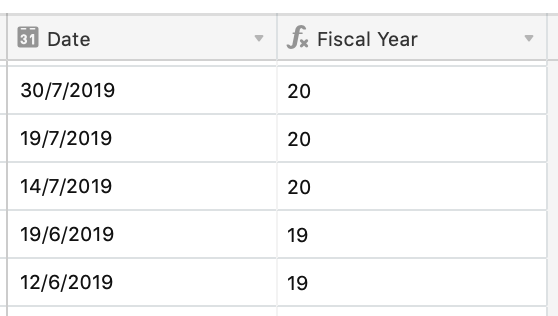

Nice one Nathan. You can also use the following formula in a single field if you’re happy with just returning the digits of the fiscal year (without the ‘FY’).
IF((DATETIME_FORMAT(Date, 'MM'))>6,((DATETIME_FORMAT(Date, 'YY'))+1), ((DATETIME_FORMAT(Date, 'YY'))))
*or replace both 'YY’s with ‘YYYY’ if you want ‘2019’ rather than just ‘19’.
I think one other issues was due to ASCII / Windows type of quotes instead of the standard UTF8 quotes .
