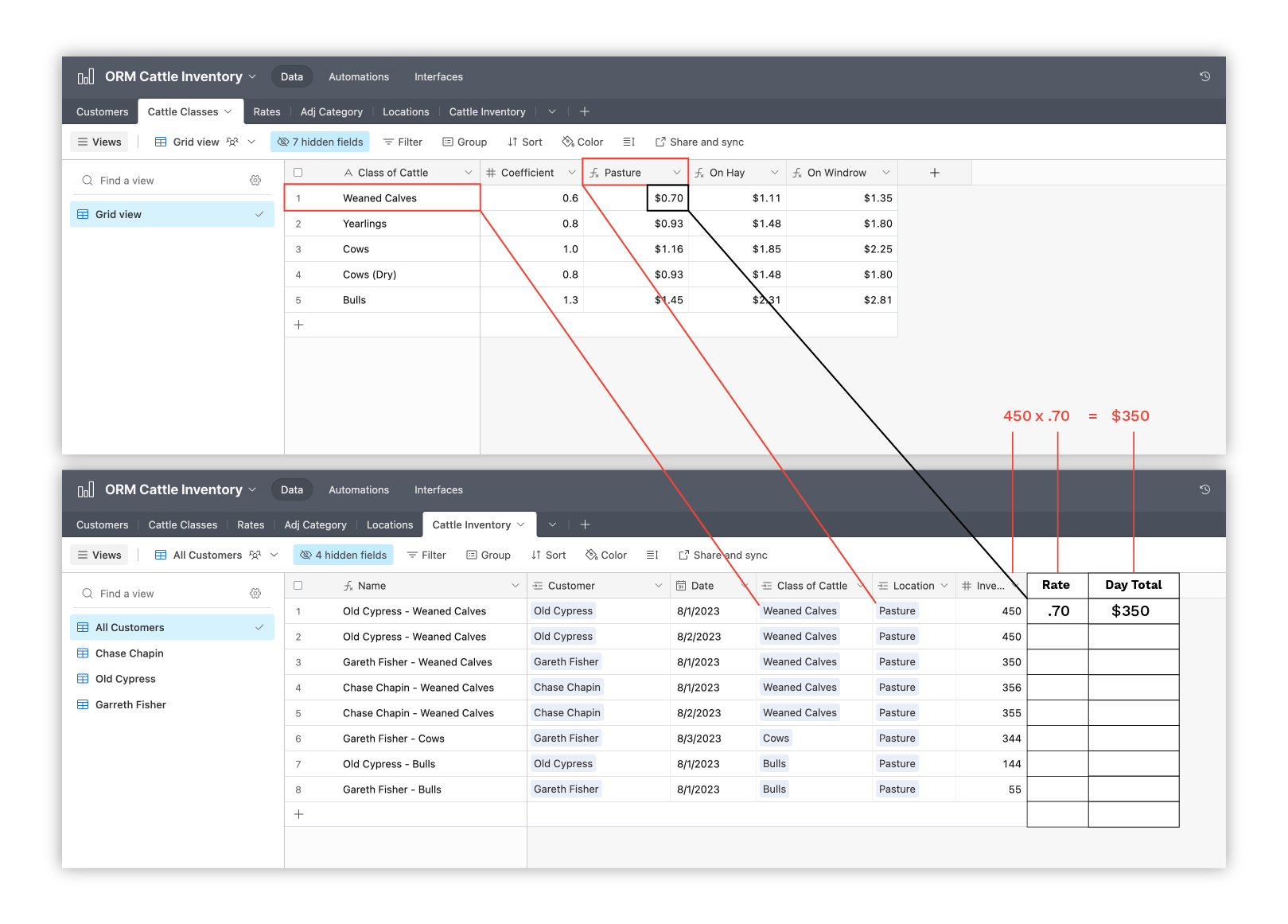

I am trying to solve the problem that I have illustrated in the image below. I am trying to create/calculate (see image) {Rate} and {Day Total}. In the below example, the first record for "Old Cypress - Weaned Calves," if the "Weaned Calves" == "Pasture" then pull in the value .70, and then multiply that value with the "Inventory" of 450. This will result in a "Day Rate" of $350. Any help will be appreciated! Thank you!

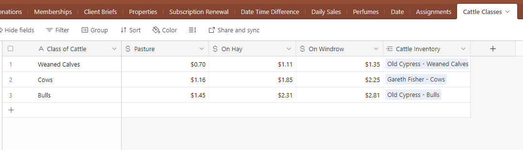

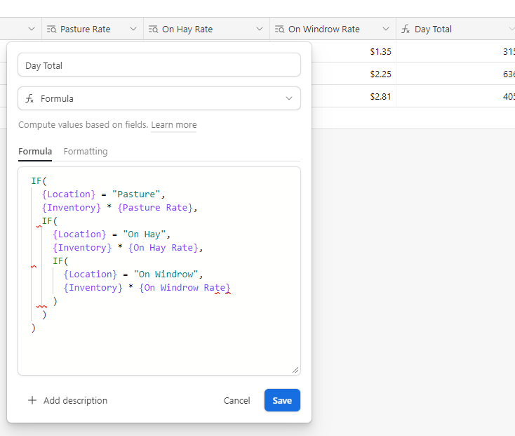

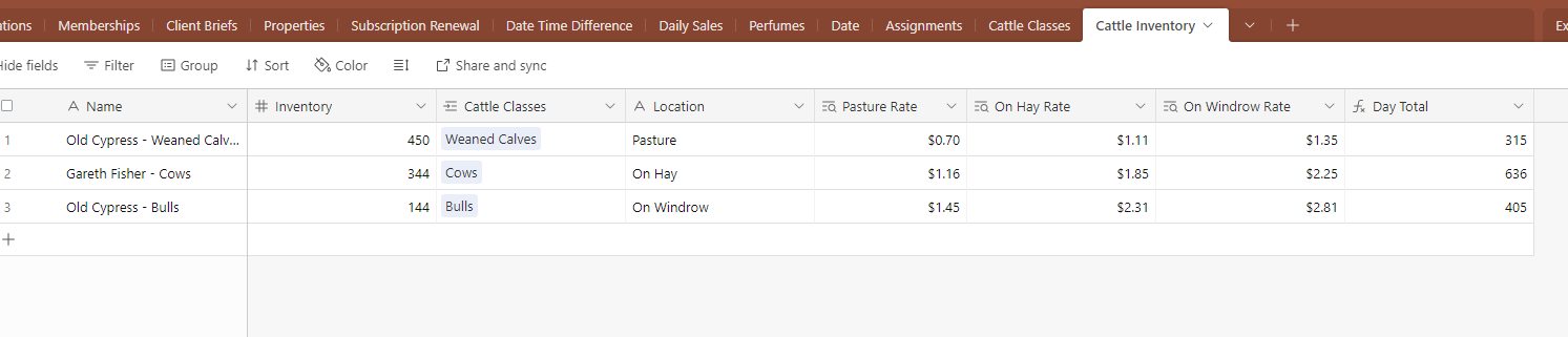

@MilhoanDesign Put together a formula you can use to calculate the day rate. Also recorded a quick Loom Video to take you though step by step how I set it up.
Table Structure:
 Day Rate Formula:
IF( {Location} = "Pasture", {Inventory} * {Pasture Rate}, IF( {Location} = "On Hay", {Inventory} * {On Hay Rate}, IF( {Location} = "On Windrow", {Inventory} * {On Windrow Rate} ) ) )
