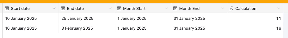

The issue is exactly what DisraeliGears describes, and so the idea is to convert the date into a number that MAX and MIN can use, then format it back into a date so that WORKDAY_DIFF works fine
We do this by using ‘DATETIME_FORMAT’ to convert it to the unix timestamp format ('x'), which gives us the date as the number of milliseconds since the epoch.  That way, MAX and MIN can properly compare the two values numerically
After choosing the latest of the two start dates and the earliest of the two end dates, we convert them back into datetime objects using DATETIME_PARSE(..., 'x'), and finally calculate the number of working days between them with WORKDAY_DIFF
Feels like there might be a cleaner way to do it, but eh it works
It works! Amazing! Thanks you ​@TheTimeSavingCo & ​@DisraeliGears01!
This makes sense and a bit of what I was expecting needed to be done (convert to a string then back to date) but couldn’t wrap my head around it.  I also wasn’t familiar with using the “x” to convert to the unix timestamp so great to know!!
Thank you so much - knew there had to be a way to solve this so I’m so appreciative. 🙏
